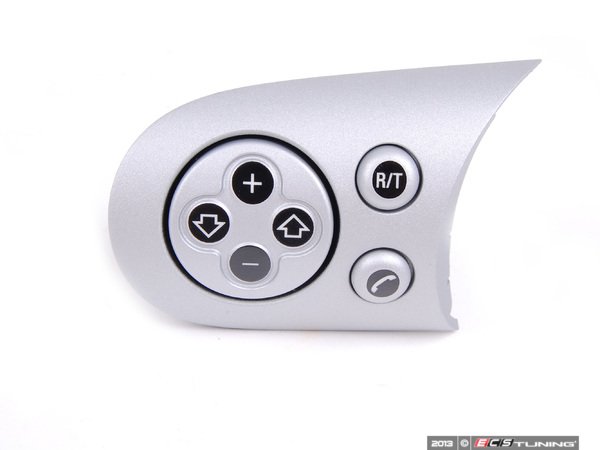

Then the key pads left and right, plus the bottom silver insert.
#2 Three Spoke Sport Wheel Radio / Telephone Cover - Left part #61316952454/
http://www.ecstuning.com/Search/SiteSearch/61316952454/

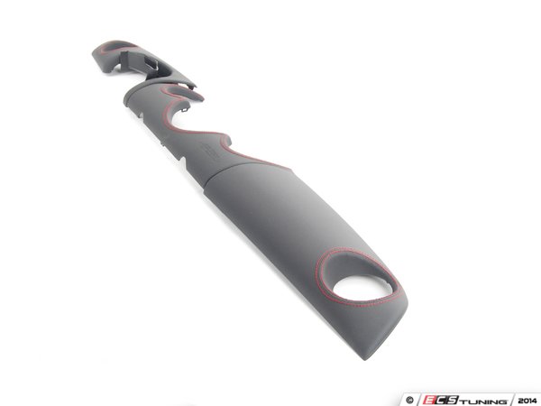

That picture above shows the very nice JCW 3 piece Leather dash ( 7/2004+) and matching JCW Leather Down tubes (R50 R52 R53). We have those here.
JCW 3 piece Leather dash ( 7/2004+) Part # 51450404445
http://www.ecstuning.com/Search/SiteSearch/51450404445/
JCW Leather Down Tubes Set W/ Red Stitching - Priced As Set part # 51450404446
http://www.ecstuning.com/Search/SiteSearch/51450404446/
