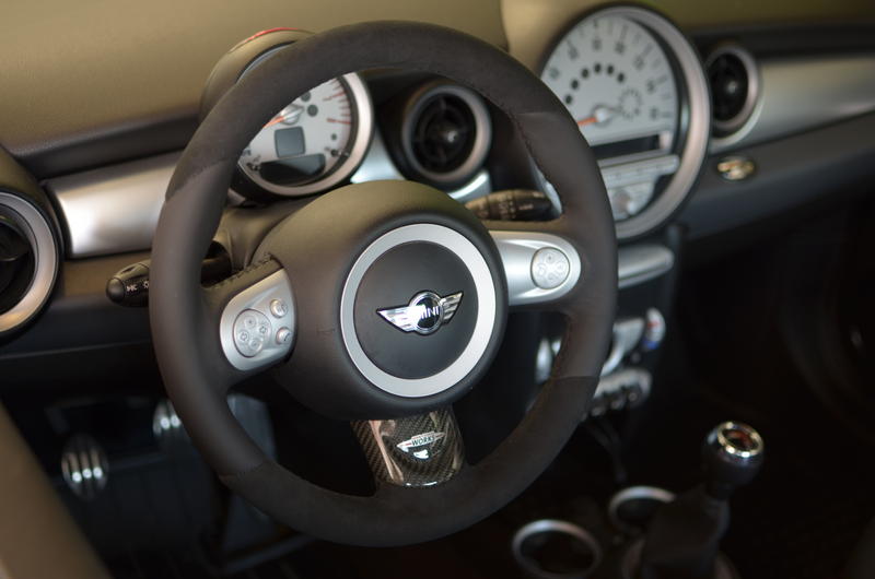

Just did mine recently (2011 stock MCS wheel to JCW leather/alcantara).
It was pretty straight forward including airbag popping and MFSW swap, following the PDF posted above. I tightened mine to 63 nm. Pretty close to 46 ft-lb posted above.
One piece of advice: have some shop towel, plastic bag or something to cover your legs/seats when you work on this. There are some very bare looking metal pieces in there, and the screws holing metal bracket/retainer thing to the wheel are pretty darn tight to take off/put on. By just removing those screws, I got a bit of tiny metal flakes on my seat and I had to very carefully clean them up.
Good luck!
End result.
