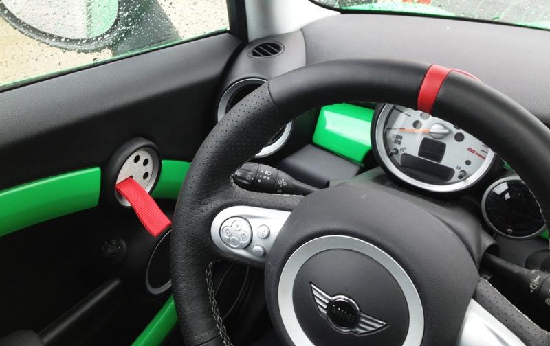

The BRG cubby cover came out nice. Don't think blacking out the silver bits would be at all ricey as long as the painting isn't half-arsed. Body color would have to be tastefully used, but could become ricey pretty easily, IMO. But then some would say my factory black/red seats and red color line are ricey, so there's no accounting for taste.

I think paint-matched trim looks fantastic. That's why I had mine done on the S-Hatch. Sure it looks pretty bold but I wouldn't call my interior ricer. When the car is wrapped up and cleaned up I will post some high-quality pics of both the interior and exterior. Don't mind all the things out of wack, this was immediately after installing the gauge and well cover.

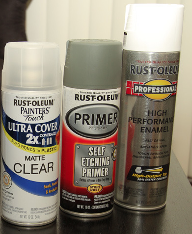

I see a lot of people talking about going to a body/paint shop and getting expensive painting done. I used three types of spray paint on many exterior and interior parts and the finish is perfect and I don't feel like it will chip or crack at all.
I used these three things:
-Don't sand anything.
-2 coats of the self-etching primer.
-5 to 7 light coats of paint.
-5 to 7 light coats of clear coat. Matte or glossy.
-Let dry overnight and install carefully.
I'd say it's completely cured in about 48 hours .
This worked very well for me and was easy, fast, and cheap which is typically an impossible combo.
