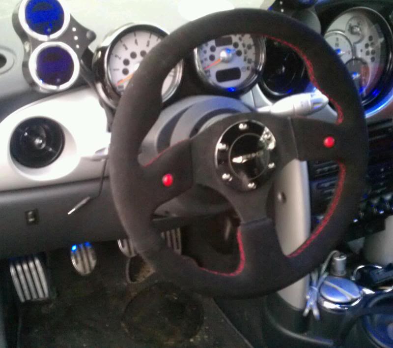

Interior/Exterior Insalled some Gauges
Just got done doing most of the install on some new gauges.
Left to right, Boost, Volts, Fuel Pressure, Dual Temp. ( I'm doing IAT & Engine Compartment for now)
Still need to hook up the sensors for the Fuel Press. & Temps, but it's going to be this w/e at the earliest before I can get to that.
All from:
http://www.veisystems.com/home.html
All electronic with external sensors.
Because of the major PITA of removing an '05 dash pad I just ran everything to the windshield, along the dash line & behind the pillar cover.
Gauges may not be that hard, but let me tell you they're extremely time consuming to do, all the electrical connections are soldered, pluged together & shrink tubed, no crimps here.
The blue is really easy on the eyes at night,
The gauges have a bunch of great features:
All:
9 different brightness levels for both day & night
Boost:
Customizable settings for boost range 12 to 60 psi
One touch peak boost display from last reset.
Displays in either 1, .05, or .01 increments
Custom calibration for accuracy

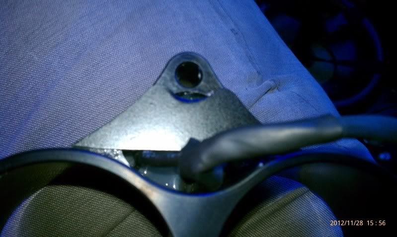

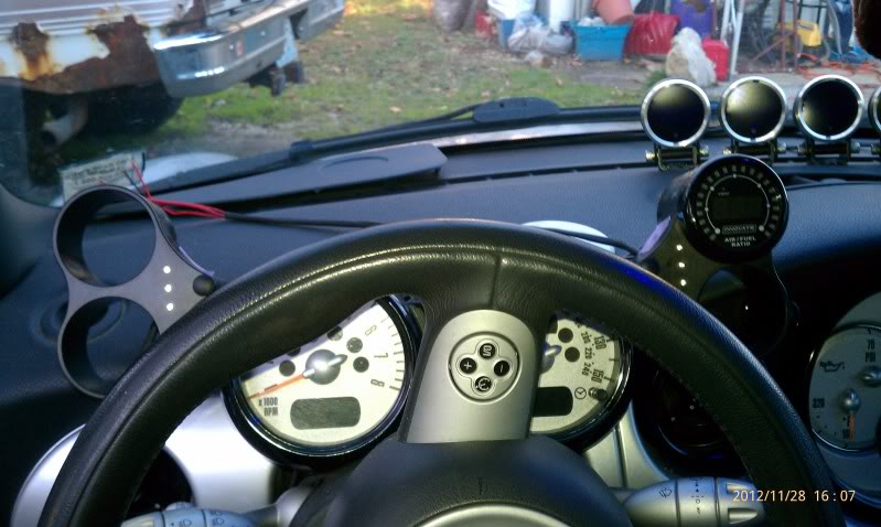

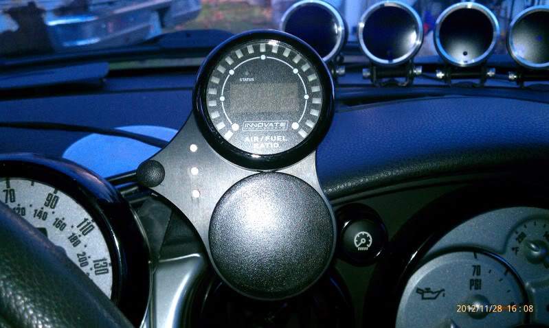

Ok, I know the multiple gauge thing isn't for everyone, but I really like as much information & early warning as possible, and with the new Nitrous install & upcoming W/M install I knew I was going to be adding at least 2 more. (NOS psi & W/M)
I absolutely did not want to string any more across the dash, so of course it was time to add some on the Chrono Pac, but I also wanted to add some indicator lights for my new goodies, so here's a way I could do both.

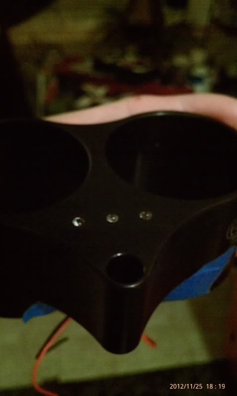

I found some old Craven Speed Double Cup mounts. (old because they don't actually sell these any more.)
Then Inset some 3mm led's into the housings for the indicators. (single cup mounts really don't afford the room for this, therfore double cups instead of 2 singles & a Y bracket)
B
I was thinking of having them both run horizontal across the top of the steering wheel, but they were just too high for my liking, so I opted for verticle.
Now, until spring & I do my W/M install I'm going to have a couple of empty spots, so instead of just bare wholes I found these at my local Ace Hardware, they call them 2" nylon hole plugs.
A little black satin spray paint & I'm much happier.

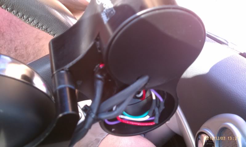

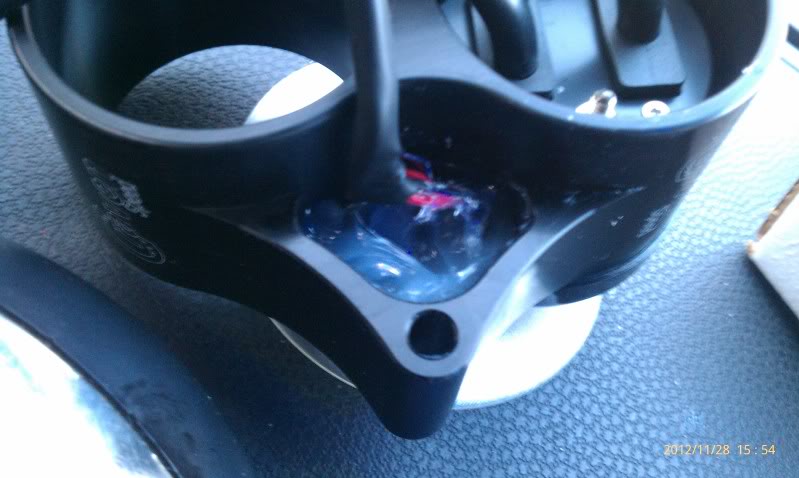

Now for the backs, had to silicone the led's in place & didn't really like the unfinished look. (I know it's just the backs but if I'm gonna do it, might as well finish it off as nice as possible) so I made some little cover pieces.
Before.
After.
And lastly I wanted to finish the back of the gauge cups too, so again with the hole plugs from Ace, here's a shot of one done, one not.
And here's everything done,
Indicator lights are:
Left (all red)
NOS on
NOS Bottle Heater on
NOS Remote Bottle Opener open/close
Right (all blue)
Rally Lights on
W/M on
(future / open)
Suprisingly enough, to me, it's not quite as obnoxious as I was affraid it might be when sitting in the car.
BI was thinking of having them both run horizontal across the top of the steering wheel, but they were just too high for my liking, so I opted for verticle.
Before.
After.

i have been constructing a custom mount to put the 3 oil and coolant gauges on top of the tach with the volt and boost to the right and left of the tach
that is i was constructing the mount, until i saw the post where another member built a custom "a" pillar mount for three 52mm gauges ... now i am leaning towards putting all 5 of the 45mm gauges on the "a" pillar via a custom carbon fiber "a" pillar and a matching right side carbon fiber "a" pillar cover ... decisions decisions decisions
scott
The features are the reason I went with these guy's product, besides the self programable high & low points for the alarms, the illumination levels can also be adjusted in both day & night time modes. I do agree an analog style setup would look really good, it would tone down the whole thing, I just couldn't find that style with the features I wanted, plus when I got the first set, I thought that would be it, then I just wanted everything to match.
Just as a supliment to this, because of the new / smaller steering wheel I was able to move the gauge pods to the lower mounting position, much less "in your face" I like them far more now. I guess it's true, location, location, location.....
Before:
After:
Before:
After:
BlnAway...I love it. Of course you've moved on past me for mods w/Sprintex/NOS. I have the heads up from Defi and really love it. I'm not sure that they make it anymore or maybe there's another version but it's cool. I have the water to air and a nice gauge for that is the Mark V Digital Intercooler gauge that tells in/out/difference.
Those would just about max you out.
my I/C double readout is on the dash. I am however trying to figure ou what to do to fill the current open space (pos. 3) on the dash, the Aquamist gauge will go on the column, so not sure what I'll do yet, I'm a "little"
mental about some things & I really like the spacing & look of the four up there so I will fill it with something, possibly their Valantine Remote Indicator gauge.
BlwnAway - looks good! You've done a lot of work. Aquamist gauge on the column=Like
