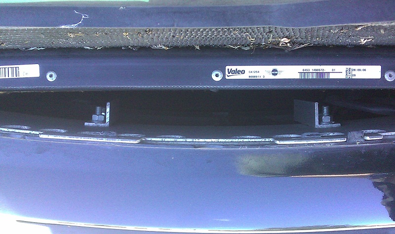

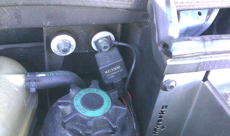

My kit consists of a set of Westin 4x6" rectangular lights mounted on a piece of aluminum 1" right-angle bar. I snipped out two small sections of the black plastic mesh out front. I drilled four holes through the bumper, consisting of a total of eight holes because it's hollow. Two 4" bolts are passed through the back, and aluminum tubing takes up the slack between the bolts and the front mount. The loom is wound toward the rear firewall, and the relay is mounted on a post right behind the power steering overflow tank. If memory serves, I cut a hole in the firewall behind the brake pedal in the seal to pass the wires through. You can reseal it with some clear sealant (you can get a tube of Beacon 527 at Michael's Arts & Crafts for $5).
I installed the kit light switch on the panel underneath the steering wheel. You have to use a long-shaft screwdriver and press downward in the space. I drilled out the hole and had to snip the factory switch mount points on the inside to get clearance. That position in the upper left corner is the only one available; the rest of the panel is comprised of two layers of plastic.
You can get the kit at Amazon for about $51. Just type in "westin 0405" in your search. Here is the final outcome: http://www.cybertekit.net/mini/2006/mini037.jpg. I was not anticipating it, but the install proved even better once I realized the mount bar was behind the license plate. It makes the lights look like they're "floating."
The only downside to this kit is the positive leads come from the positive battery terminal, so it's considered off-road use only. If you want to make your lights more factory-like, you will need to determine which lead(s) are for your brights. If you have the daytime running lights turned on in the ECU, which use the brights in a low-beam fashion, your kind-of out of luck (unless you have the feature turned off).
