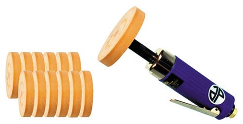

BTW, if you remove your stripes, go to a bodyshop and have them use a stripe remover. You’ll remove the stripes much easier with no damage.
You can use a smaller one like this.
or a bodyshop would use one like this. (except with a rubber wheel instead...lol)

I apologize, I should have been more clear. The stripes on your mini (assuming BMW stripes) are of a good quality. They should peel off if done slowly and with heat. (make sure you grab the stripe at the base near the hood, don't grab it by the end)
IF they start breaking off and just don't seem like they're coming off easy, THEN get a stripe remover. In either case, you shouldn't damage your hood/paint if done with some finesse.
