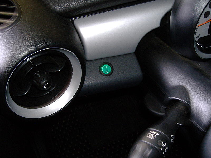

This is a Hella driving light switch mounted in the usual oem position. The switch is illuminated when in the "on" position. I wired it so it controls both the driving lights and the oem fogs that I installed. When the switch is "on" it turns on the fogs with the low beams and the driving lights with the high beams.

Bringing up a thread from a while ago.. buuuut this is what my switch we just installed looks like:
Please excuse the messy MINI. I've seen a lot of threads around saying that this is impossible, or really sketchy to do. We didn't have to drill a hole through the circuit board or anything.

SooperSara has her button where the "REAR" fog toggle switch goes. She has her non-mini lights connected perfect. The button looks good where she has it placed.
I only have the Mini driving lights installed. If I decide to add some hi-teck after market fog lights I will probably look into where she has her button installed.
Nice! I like the green switch!
