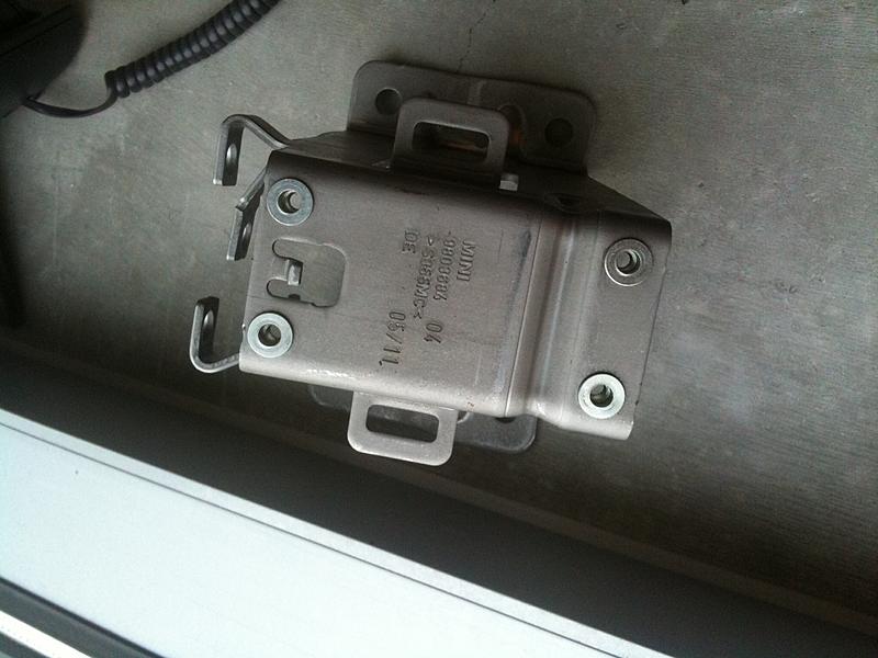

So i got the armrest and now i'm confused a little.
There are 2 screws which go into the bracket plate that goes under the rail that is bolted to the bottom of the car, and i can see the 2 more holes in the rail but they go no where. If you look at the bracket, you are supposed to secure the screw with 4 screws (http://www.realoem.com/bmw/showparts...0&hg=51&fg=35).
so
1) i need to get 2 more screws, possibly 4 if the ones i already have are too short.
2) find out where the other screws go.
Last edited by maxdbunny; Apr 18, 2011 at 08:19 PM. Reason: I looked in my car to see if i had the bracket or not
Old Apr 19, 2011 | 06:03 AM
Miniblue2's Avatar
Miniblue2
Joined: Dec 2010
Posts: 500
From: The Woodlands, Texas
I was sure they would give more detailed instructions. From the parts list it doesn't look like the four holes are drilled in the support bracket.
In my MINI with the center armrest it there is a square hole in the rail, the rail bottom plastic fabric is removed and there are four bolts through the rail fastening the armrest to the support bracket.
On your MINI is there a rail support between the seats or is it only supported front and way back?
Thanks,
Bill
Old Apr 19, 2011 | 11:32 AM
maxdbunny's Avatar
maxdbunny
Joined: Mar 2011
Posts: 13
From: Los Angeles, CA
So the support bracket is drilled and threaded for the bolts to hold the arm rest in place. As it turns out, i already have the bracket in my car or some form of it
since i dont have an arm rest the center rail is attached by 2 bolts to the bracket (the same bolts according to the part number that you'd use to attach the center arm rest to the rail and bracket) but the arm rest requires 4 bolts, i only have 2, and if you look at the rail in my car, there are 5 holes, 4 for bolts and 1 hole for the bracket hook thingie (see crappy iphone picture) its the middle hook prong thing.
Also just so this is documented somewhere, when you buy the center arm rest from outmotoring.com, at least for me, they sent the one that has the Smart Phone cradle. It has a extra wiring harness that i need to figure out what to do with, since i have the bluetooth installed in my car it seems redundent to have another way to connect your phone.
