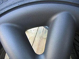

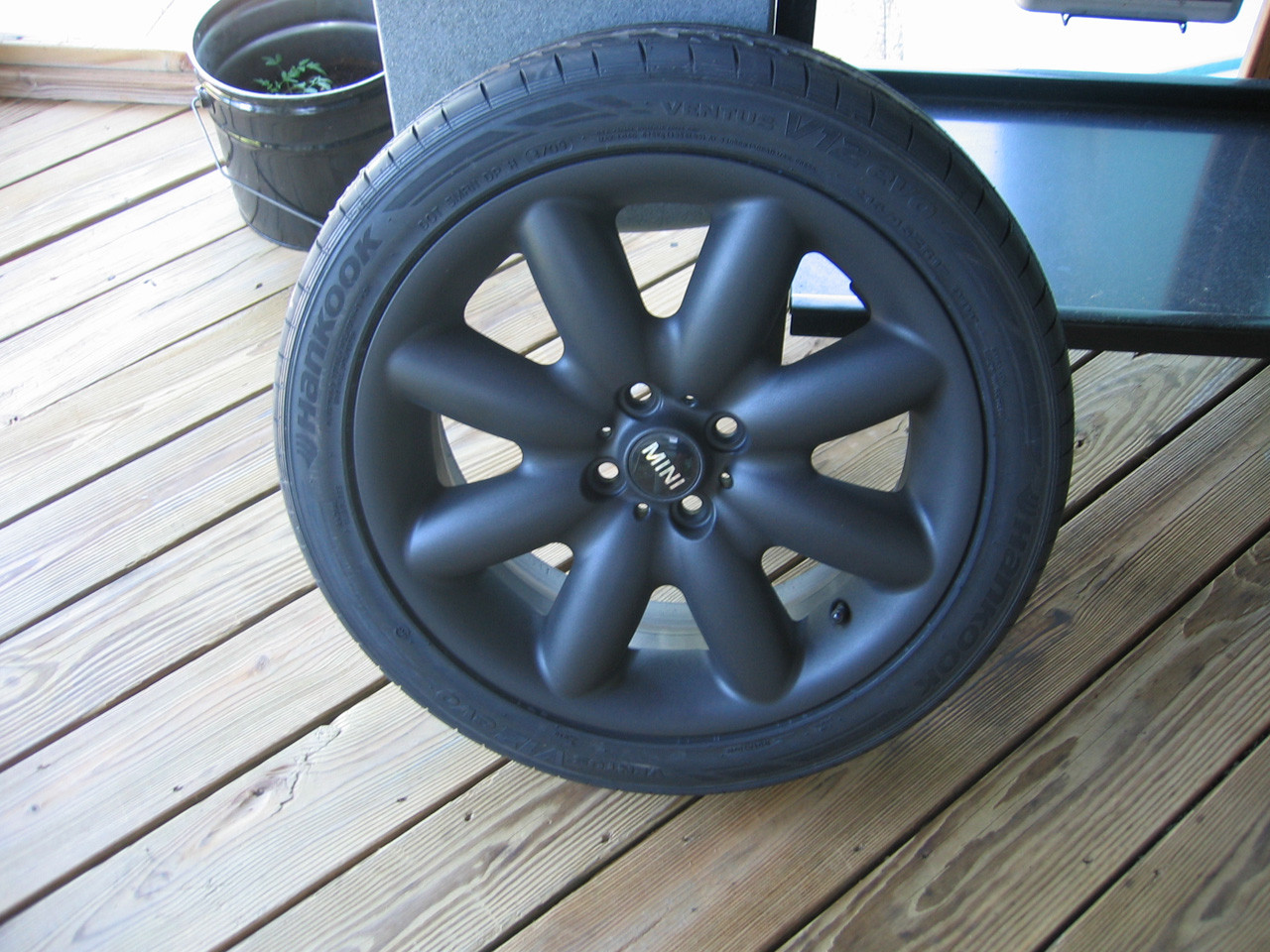

Had new tires mounted on my S-Lites and decided to Plastidip them while they were off the car. Prepped by washing them well with dish detergent, then wiping down with isopropyl alcohol. I'm not holding my breath to the longevity of it, but for $18 bucks and a few hours of my time, it's worth a shot.
I did two heavy coats, then 2-3 lighter coats to get a texture and hide some imperfections.

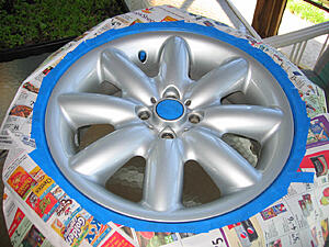

masked the center cap before I realized I could pop it out

Gotta say, that looks really good. Interested to see how long it lasts. For 18 bucks and some time wouldn't be too big a deal to do it once a year or so.

Pretty neat way to "try out" a different color of wheel before you pay $$ to get it done for real!! Looks pretty cool!

I'll probably get sick of the look long before I need to tires The tires in the pics are brand new 215/45/17 Hankook Ventus V12 Evo K110.

True, but the reason I went with the Dip is the ability to return to the original surface

Well it's been over 2 weeks and they look as good as day 1

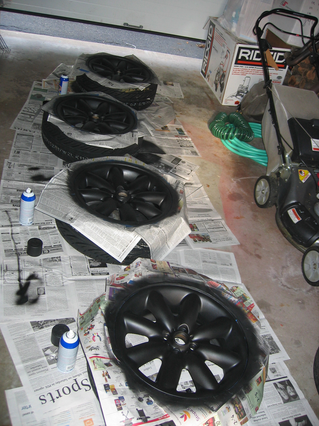

Ive got some pics to share
Sadly they wont be on until the coilovers are though
THIS is why im painting them.... :(
EDIT:
quick on the car shot. theyre a tad dirty

Using index cards for masking material is BRILLIANT! Trying to run painter's tape and newspaper around in a circle like that is a nightmare, but the cards just slot in there... too easy!
Max is in the shop right now (busted exhaust header and belt tensioner) but the moment he gets back, I'm pulling the rims off and trying this again. Since the centers of my wheels are covered by a larger cap, nobody will see the paint job under there, and I'm thinking of just masking out where the lugs would be... just to prevent a repeat performance.

The only problem with the index cards is if you run a wide tire. The lip of the tire will push the car against the edge of the rim, so once you're done painting, there will be a noticeable silver ring on the very edge. That's why I opted to go with the tape (which wasn't much of an issue, each wheel took less than 5 minutes to tape up).

Yeah i couldnt use tape on the tire as Ive had waaay to much tireshine on them, which will not come off completely lol. Even after all my prep cleaning.
You can also use index cards to wrap the valve stem, which i did, and probably even insert lightly rolled ones into the lug holes to block them... I would assume youd need to remove them prior to the paint setting though
I pulled the valve stem ones off pretty early
