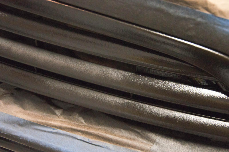

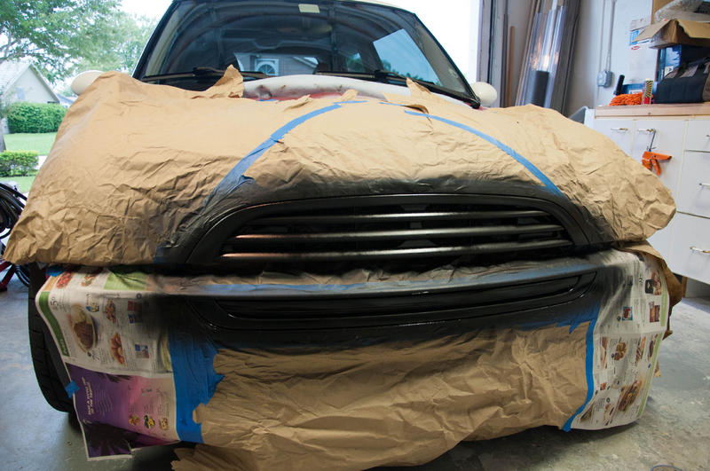

I started taking my upper grill off and broke the first plastic retainer on the grill. So I taped it off. Taping took around 40 minutes to do a thorough job. To take the 11 nuts off the upper grill it would take a lot longer. I would strongly recommend taping the grill off. I was able to get the tape perfectly between the grill and the paint on the car so no overspray would get in between the cracks. Pictures below were taken while paint was wet.
The Can says to wait 4 hours between coats, but someone here suggested waiting 30 minutes. Any suggestions???
Attached Thumbnails Plastidip'd my grill slats-dsc_1864.jpg   Plastidip'd my grill slats-dsc_1865.jpg   Plastidip'd my grill slats-dsc_1866.jpg

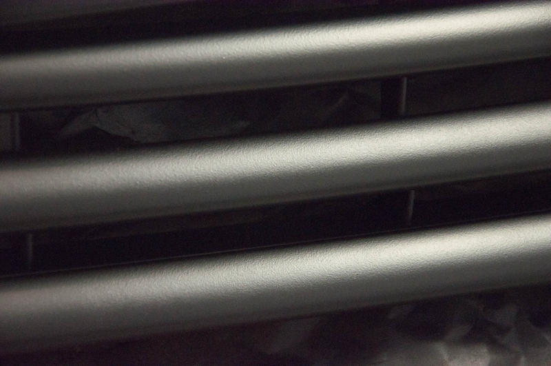

The PD can actually says wait 30 minutes between coats. My old eyes are deceiving me. Anyway, I waited 45 minutes between the first and second coat. Pictures below taken 45 minutes after the first coat. Second coat was much lighter than the first coat so this time I will wait maybe 30 minutes.
Attached Thumbnails Plastidip'd my grill slats-dsc_1867.jpg   Plastidip'd my grill slats-dsc_1868.jpg   Plastidip'd my grill slats-dsc_1869.jpg

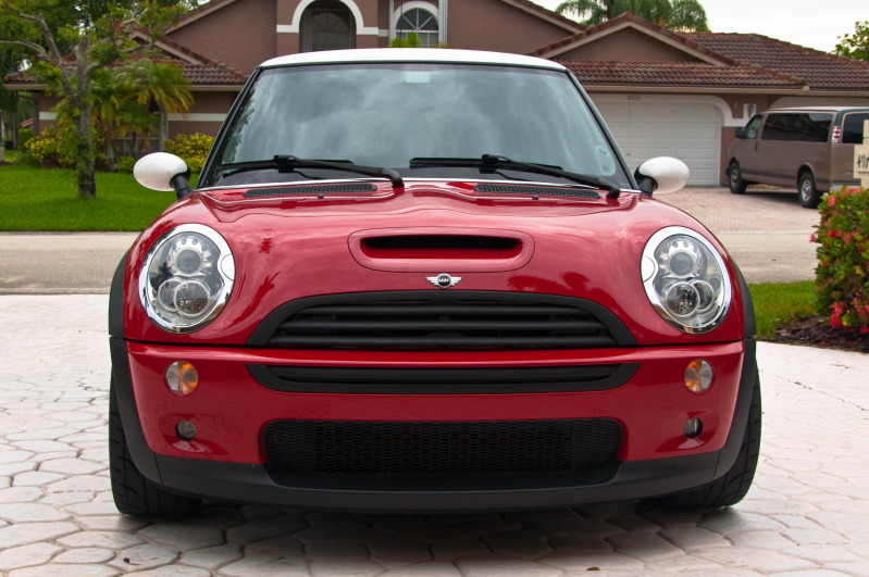

Finished Job
Here is my finished job for Plastic Dip Grills. It was very easy to do and highly recommend taping off instead of removing the grills. One can does the job and I was able to get 4 coats on there with a little left over for touch ups. I left the tape on over night to allow more time for drying. Use a utility knife before pulling the tape in the grove between the body and grill to cut the paint before pulling and go slow. I had a slight booboo at the top section which I will touch up later. This is a temporary stop gap until I get a Aero bumper and grills.
Let me know what you think. Do you think I should do the headlight surrounds. Car has a white top. Thanks.
