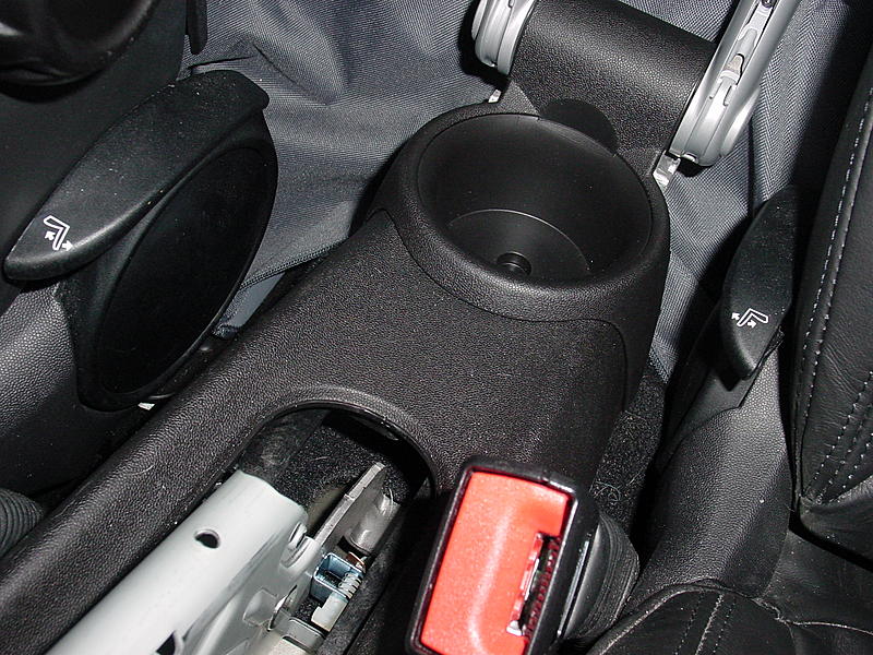

MINI 'Euro' Armrest
Originally Posted by jrcsh6
this is the one i have. the only problem is that it sags...not a level armrest (not mine at least) so i used a bunch of felt in the jam to level it.
I had installed this armrest a little over a year ago and it was the best choice for me.
I had also noticed the distinct 'down slope' and assumed it was to accomodate Manual Shifting for extra tall people.
Photo below shows my initial modification; using a taped wine 'cork' (the hard rubber version):
Click HERE to open a large, expandable copy of above photo in a new tab/window.
The tape was temporary (to establish the angle most comfortable for me) and I then used contact cement to attach that shim to rear of armrest,
where it can't be seen and it has remained for nearly a year now.
Bottom line is that although it is easy to raise the angle to suit your comfort, it would be impossible to lower it,
the framework is very strong steel construction from below the the seat rails and you could stand on it and not lower it at all.

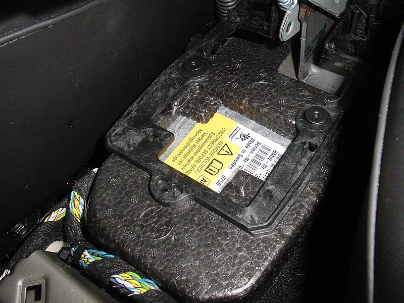

Ugh...Morristown sent me two right hand covers (even though one of the labels was marked with the correct left-hand part). UGH UGH...
Second, where the HECK does that styrofoam padding go!? I can't figure that out for the life of me...Does it go below the plastic braket, above the bracket below the arm rest, does it go near the armrest or up by the parking brake?
I finally figured it out, it went over the airbag computer! Strange how the original bracket does need that padding...very strange!
Last edited by strobeyprobey; Jul 24, 2009 at 04:49 PM. Reason: Figured out my answer

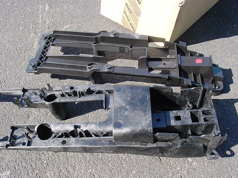

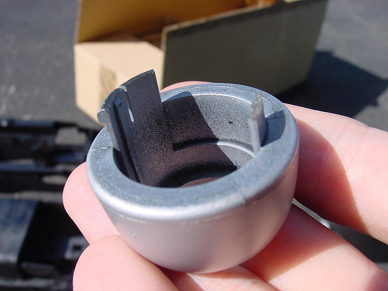

Done (well almost)
Okay, so the factory armrest conversion is complete (except for the left-hand cover trim)!
Took about 30 minutes to take the center console out, and the bracket. I highly recommend nylon "installer" pry bars to pry the trim rings around the shifter boot and the parking brake boots. Took about 40 minutes to put it all back together.
So be careful when you pull the parking brake trim off (see attached picture) as I broke one of the tabs. Seems to hold okay without it.
I needed to move four plastic tabs that the major console piece slides into from the original bracket to the new one. Then I needed to move the red piece that the screw from the cup holder screws into the new bracket. Then I added the "padding" foam piece to above the airbag computer since the new bracket is much longer. Reinstalled the new bracket making sure I didn't pinch any wires and attached the parking brake sensor wire into the little hole. Then I tightened the four nuts that hold the brackets down. So it was time to attach the five armrest bracket screws. Then reinstall the big console piece, making sure to get the four slide tabs set right when you push it forward to lock it in. Then I added the new cupholder with the hinge "hider" and the one ride-side trim piece. Pretty simple really.
And so far I like it! I haven't driven it yet, but I think I will enjoy having it.
I have more pics but I could only upload three.
Attached Thumbnails Factory Armrest-dsc00001.jpg   Factory Armrest-dsc00004.jpg   Factory Armrest-dsc00010.jpg

Yes! Okay, so you will need to recycle the fasteners from your existing parts if you have them still. As I just took mine apart this is fresh in my mind.
Here is what you will need to convert to a non-OEM armrest. Refer to the RealOEM site linked earlier to see these pieces.
51162752947 Bracket that mounts underneath the console (Part 2)
51162756167 Cupholder (Part 14)
51162756171 Cupholder Trim Ring (NON CHROMELINE, Matte Grey plastic Part 15)
OR 51162756172 Cupholder Trim Ring (CHROME LINE Part 15)
Those three parts are what you need to order if you have all of your fasteners still.
IMPORTANT! Please note you will need to move the four plastic clips from your big bracket to the smaller bracket part 2. They are Part 8 07131481910. You also need to move part 22 07130657024 from the bracket old bracket to bracket part 2.
Also, you can remove the Styrofoam padding part 19 above the airbag computer.
You will need to reuse part 9 51418247775 the screw in the center of the cupholder into the new cupholder. Also the four bolts part 5 07129903094 that attach the bracket to the car will need to be reused.

I am in the process of retrofitting my MCS 2008 with an OEM Armrest. I disassembled the Center Console to remove the original bracket and replace it with the new one.
My question is: the new Padding where the ABS module goes doen NOT fit well as the wire is a bit short. Also does it rest under the end of the new bracket so it stays in place? Somehow the styrofoam padding looks clumsy and poorly designed. Thanks!
[/QUOTE]Second, where the HECK does that styrofoam padding go!? I can't figure that out for the life of me...Does it go below the plastic braket, above the bracket below the arm rest, does it go near the armrest or up by the parking brake?
I finally figured it out, it went over the airbag computer! Strange how the original bracket does need that padding...very strange![/QUOTE]
Old Mar 1, 2012 | 07:12 PM
  #49
strobeyprobey's Avatar
strobeyprobey
Joined: Apr 2008
Posts: 1,303
Likes: 12
From: Twin Cities, Minnesota
The black styrofoam sets right on top of the airbag computer just behind the shifter. It sits very snuggly. Just sets right on top of the aluminum box. Keep trying to get it.
