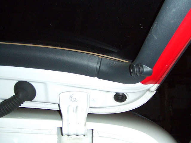

The only hardware are the nuts that go on the studs and 2-sided tape. Both you can get at Home Depot. Get the outdoor 3-M red covered tape for that job.
In this pic
you see just to the right of the hing a black cap, remove that cap and thats where you will find the nut and hole for the R50 OEM Spoiler and I think it's also where you will find the same nut and hole for the R53 OEM Spoiler too. Best to get a confirm on that before you start drilling.
Measure 3 times then drill.
