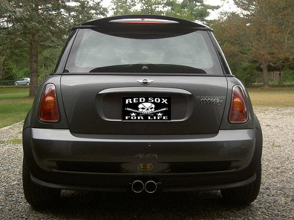

Used penetrating oil on it for day, removed next day very easy.
Used a 1" rubber plug used by Electronics companies that do antenna installs on automobiles like taxi's and cruisers. When an antenna is removed from a trunk of a car, they use these plugs to fill in hole.
I then used some black silicone adheasive on back side of plug because it was not as snug as I wanted. ( had plug in my tool box ) It's in there rock solid. But find a plug that fits a hole just a smidgen larger than 1", maybe 1- 1/4" ?.
