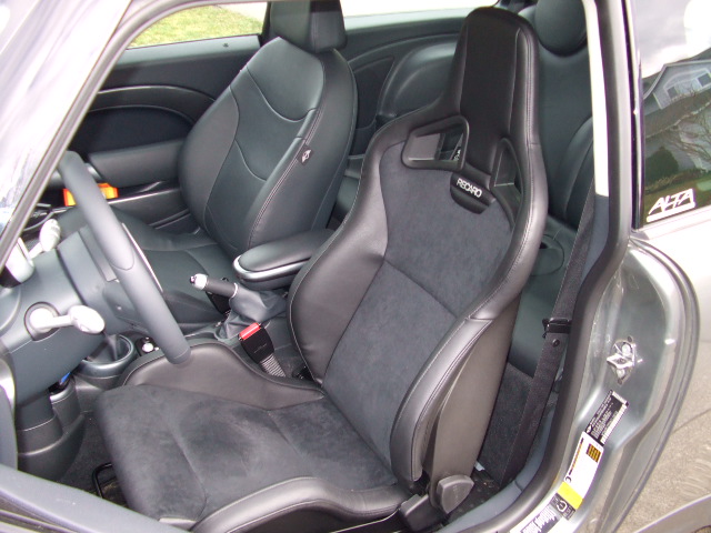

So I wasn't too happy with my seat... the left corner squeaked every time I pushed the clutch. Problem solved!!

I'd say that is a pretty good fix to a lame problem. Very nice looking seat.

Sweet!!! ...how much for the beauty?

Well I got a deal for being "part of the family" at Speedware Motorsports. Here's a somewhat staggering figure though... $1650 out the door (slider, bracket, hardware, seat, tax.). Turns out the seat, slider, and bracket all needed modification to fit the car properly. If anyone needs to know what to do with a Speedware bracket, I have a few suggestions for you.

Beautiful . Best solution to a seat squeaking problem that I've ever seen!
