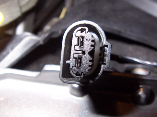

Here's a photo of the plug that connects to the bulb socket. The plastic "c-clip" is on the left. Remove this with a small screwdriver.
Now the clip is removed, and you can see the two metal tabs exposed. Press down on each one and then pull it out from the back of the plug.
Here's a photo of the back of the plug, with one of the metal tabs pulled all the way out. The other one is still in the plug. Just swap the positions and reassemble everything.
Takes 10-15 minutes if you are super careful and slow. Takes 5 minutes if you have done it before.
