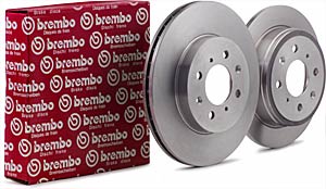

Rotors!!??? DIY???!! Help!
OctaneGuy,
Just wanted to thank you for being so detailed in your write up.
My 2003 MCS has over 60 k and I took it in to my favorite place Webster's Import Service, Greensboro, NC. Anybody in the area who has their warranty expired needs to go see them. They are the most honest guys and excellent mechanics and Roger Webster is a funny guy. After Scott and Roger Webster told me my front rotors were lipped (common with Euro. cars) and would need to be replaced with the pads they told me it would be about 330.00 to do the job. Very reasonable compared to the dealer I think.
BUT my wife has quit her job to be home with the kids and wants a Mini-van to boot. So I'm going to do the job myself. I have replaced pads on cars so I'm not afraid of that–I just need to know if there's any sticky business with these rotors. If anyone has done it please let me know if there's anything to watch out for vs a "standard" rotor swap.
Also on the 2003 as OctaneGuy noted, there's the sensor to consider. I don't have to replace it but I was wondering if anyone has used these pads–I'm going cheap her, but with 2 little ones now, the closest I'm getting to a track day is getting the Disney DVD's back to Bbuster before noon. I have attached the jpgs here–– Alex, will these pads handle the sensors?
If this needs to be moved to a new thread, great but I thought this was such a good thread it would be the place to start.
Any help will be very much appreciated!
Jake
Jake

Thanks for the nice words. Replacing the brake pads is pretty simple. The rear pads can be a bit tricky but aren't difficult once you do it. The spring clips on the back of the inner pad can be hard to attach to the piston. My neighbor who is a BMW mechanic suggested I remove the smaller springs and use a spray on brake product that is both sticky to hold the pad to the piston, and eliminates brake squeal. I tried it and it works great.
You can get a great deal on Mintex pads from
www.ecartoys.com
Looks like the prices have have gone up a bit, but the last time I bought them--back in March, they were $57 for front and back and included free shipping.
re: Rotors
I'm getting close to having to replace my front rotors. It's not hard to replace them, but you might need an impact wrench to loosen it. I've got an electric one that I bought from Harbor Freight and it moves up to 240 foot pounds. It may not be strong enough, I bought it for loosening my wheel lug bolts.
I think there is a good writeup on the rotor replacement over at Randy Webbs website. It will probably be atleast 6 months before I do a brake rotor writeup. LOL
Richard
