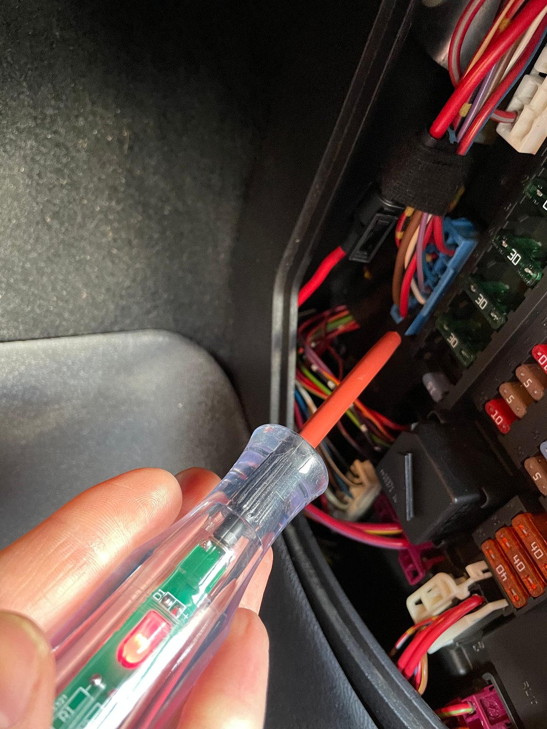

next I probed the white wire in the footwell harness that feeds the compressor clutch. Even though I could hear the ac relay click after snowflake button, still no voltage. Super confused at this point.

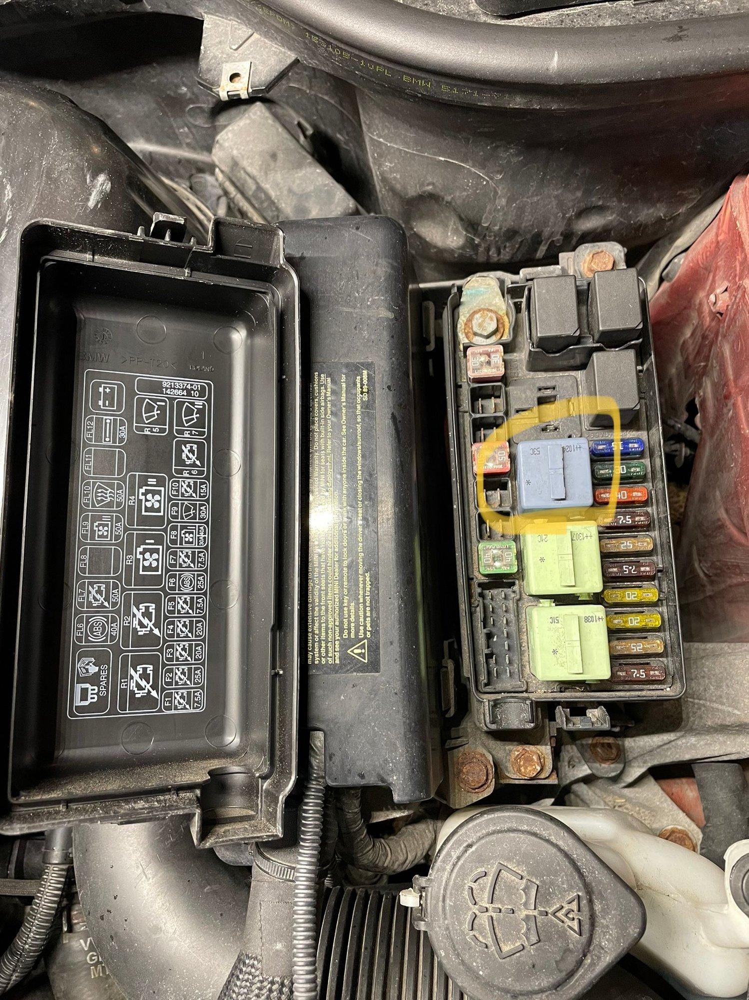

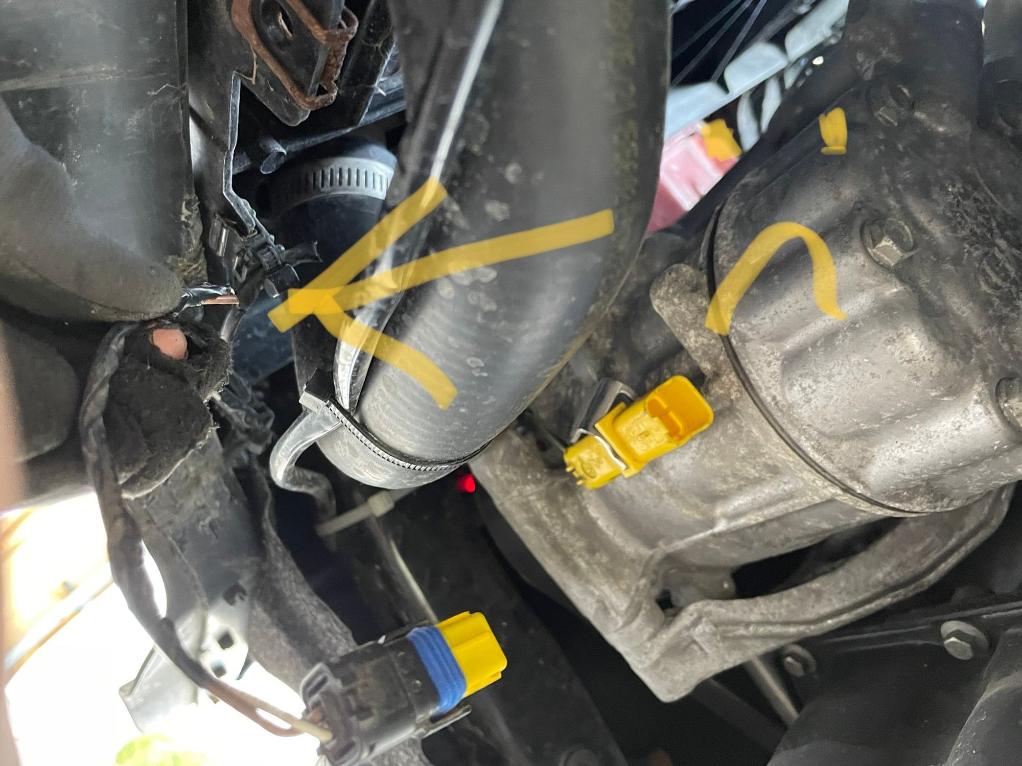

The odd cooling fan behavior from earlier comes back into my mind and I search a bit more. I see a user that had AC start working again after a dealer replacing his relay so for 30 bucks at Oreily’s why not. (Part number 25-0428) My mini only has the stage one relay so that’s what I was replacing. Pop it in when I get home and whooosh the cooling fan started up. Cool! But still no compressor. Probe for power at white wire in foot well and now it was hot! Now I was excited! Get under the car to start probing the wire closer to the harness and boy did I get lucky cause the corroded wire failed and snapped right then at a zip tie along the front bumper.
I stripped the wire and did a quick patch job with alligator clips, and click, whirrrrr AACcc.
