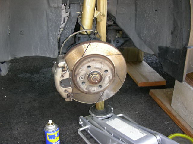

There’s no need to go through those extra steps. A length of wood (I use a 1.5”X.75”X2’ piece of cedar trim) placed under the lower spring perch with the other end on a jack pad; raise the jack to compress the spring and give the steering knuckle a rap, that’s all it takes.

Refer to posts numbers 10, 13 & 34, popping the ball joints on the control arms and pulling the calipers is not necessary on 05s either if you use a method where the spring is compressed. If you pre-spread the gap (screw driver or small pry tool) after removing the pinch bolt, then spray the lower strut with Liquid Wrench, the steering knuckle will fall freely after a few strikes with a dead-blow hammer. I’ve done this a half dozen times, using a piece of wood is easier than zip ties or endless loop tie downs.

Here’s a picture of compressing the spring using a jack and stick to facilitate clearance of the steering knuckle.

^^ don't tell me you have your car on cinder blocks... those things
collapse on their own sometimes.
i never had to use this proceedure. The whole job was fast and worked like the Photos I posted.
I don't understand why this is needed.
