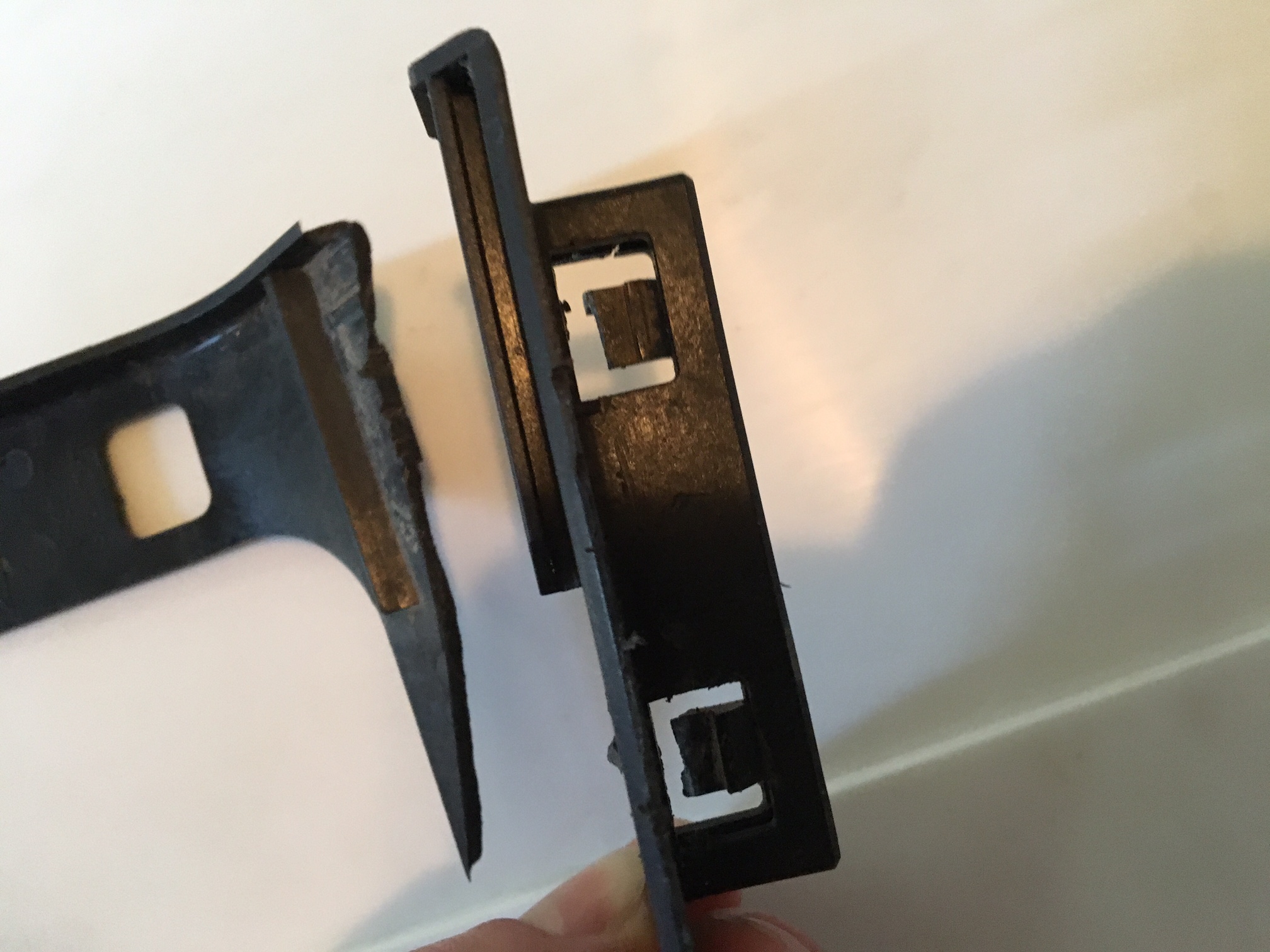

"....screwdriver to pry the tabs at the bottom"
When you are trying to do this at the bottom of the floor, it can be a royal pita if you don't know exactly where the "tabs" are. Got so frustrated I broke the bracket off to get it off.
Attached are some pictures to show what you need to do.
Basically, there is a metal vertical piece welded to the floor, the bottom of the gas pedal adapter plate has a channel that slips over the vertical bracket. There are two tabs accessible by the slots from above. Insert a screwdriver vertically from the top and bring the top of the screw driver towards the rear of the car so the barb goes forward to the front of the car. Lift up as you are doing so, then do the other side.
By the way, you do not have to mess with the rubber steering wheel piece, you can lift the tab then slide the bottom towards the left (pivot) and the gas pedal should come loose.

No problem. Your post was very informative and much appreciated. It seems the engineers at BMW/Mini go out of their way to make each part assembly as a riddle to solve.
We'll see how easy it goes on. Just may have to take the rubber boot off... Have to wait for a new bracket though
