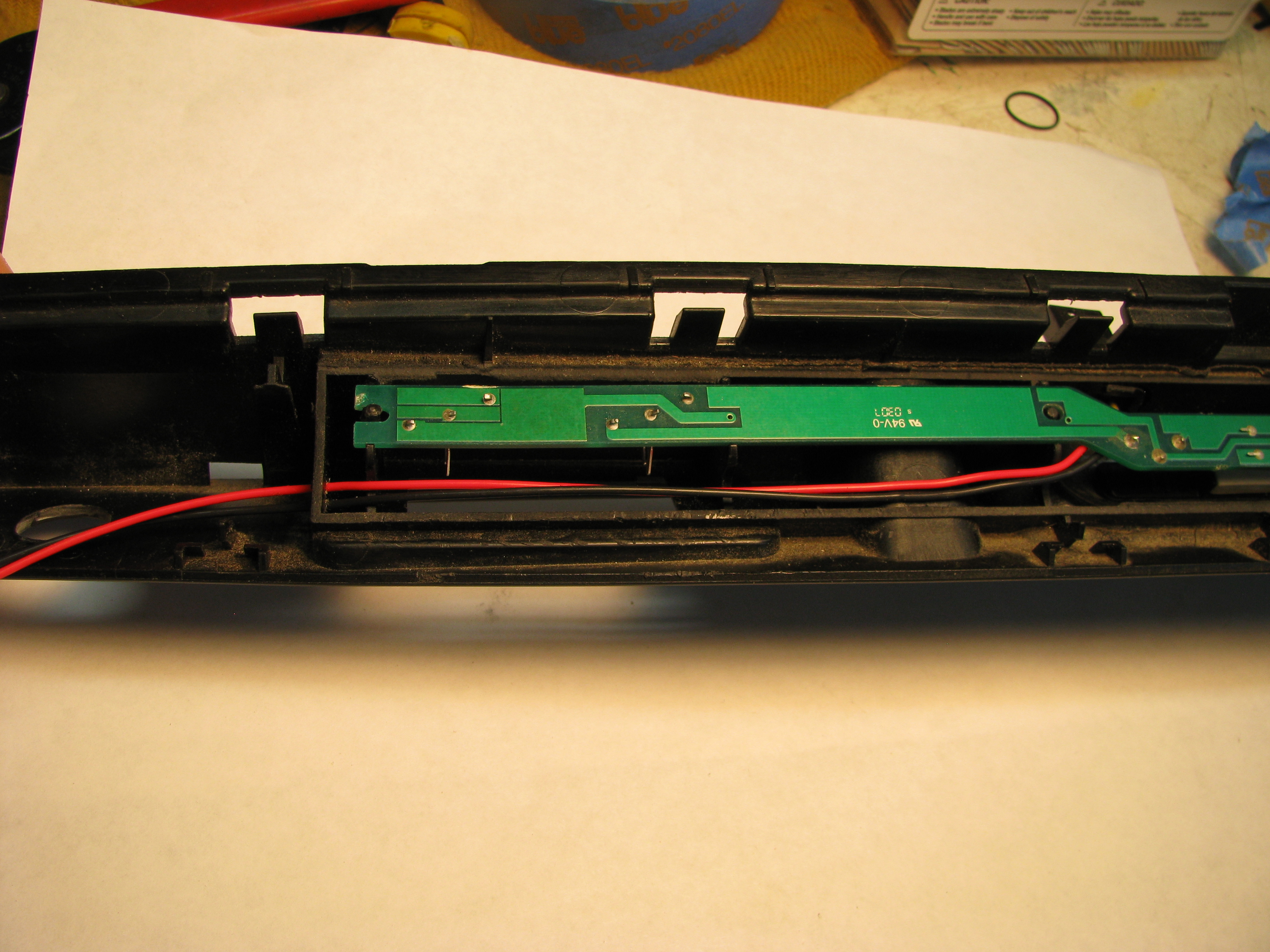

MINI Hatch Handle Release Failure
Hello Again Mr_Taipan and thanks for the quick response. Most of what I've written below is already familiar to you however I've included more detail in case other readers have interest. I followed your brave lead and was able to remove the entire switch+circuit-board+lights cover. It appears to be glued around the entire perimeter, most likely for weather proofing. I just started at one corner to break the seal/glue and then worked my way along a long edge very carefully alternating two flat-blade screwdrivers. Once the front edge was free, the back edge could be "hinged" several times to break the glued interface. It’s clear that the switch cover/spacer that you referenced broke away from the switch as you had found during your root cause investigation. I can see that one of the tiny tabs on the “cover/spacer” snapped-off so the cover/spacer could no longer grip the micro switch body (see photo). An unbroken cover/spacer grips the switch body yet allows some small travel to provide switch-actuation when the rubber hatch handle is pressed. It appears that your solution was to glue that cover/spacer to the underside of the rubber handle assembly such that it still pressed on the switch but was no longer mounted to the switch. Since alignment to the switch will then be more critical, I plan to eliminate the small cover/spacer and will use a larger area plastic “plate” ~ 5/8” long x 3/8” wide x 3/16” thick and then glue it directly to the underside of the rubber handle assembly as you did with the cover/spacer. In essence, it’ll be a larger area “finger” to press the micro switch button to accommodate the wiggly characteristic of depressing the rubber handle from outside the car. There is some slight risk to this approach. Specifically, when neither of the tabs described earlier are broken off of the cover/spacer, it looks like the bottom edge of the tabs MAY provide some small degree of travel constraint such that there's not too much pressure applied directly to the button of the switch. With the "plate" approach I described, there's no such limit stop. I hope the switch itself is internally mechanically limited. I also have a backup plan I hope to implement should there be another failure and I’ll post it if it works. Thank you for your guidance!!!
My editorial to MINI: While I appreciate what the original MINI designer was trying to accomplish with this hatch release mechanism, the design approach and implementation was awful. The designer clearly had no training or experience in Robust Design, Design for Reliability or Design for Serviceability. Even with a poor design such as this one, if the switch was at least accessible then a new plastic cover/spacer could be snapped on to the switch. That cover/spacer, which is only about 3/8” x 3/8” x 5/16”, is most likely produced for literally tenths or hundredths of a cent each, yet it ends up costing the consumer $200+ to have the entire hatch handle assembly replaced. Brilliant.

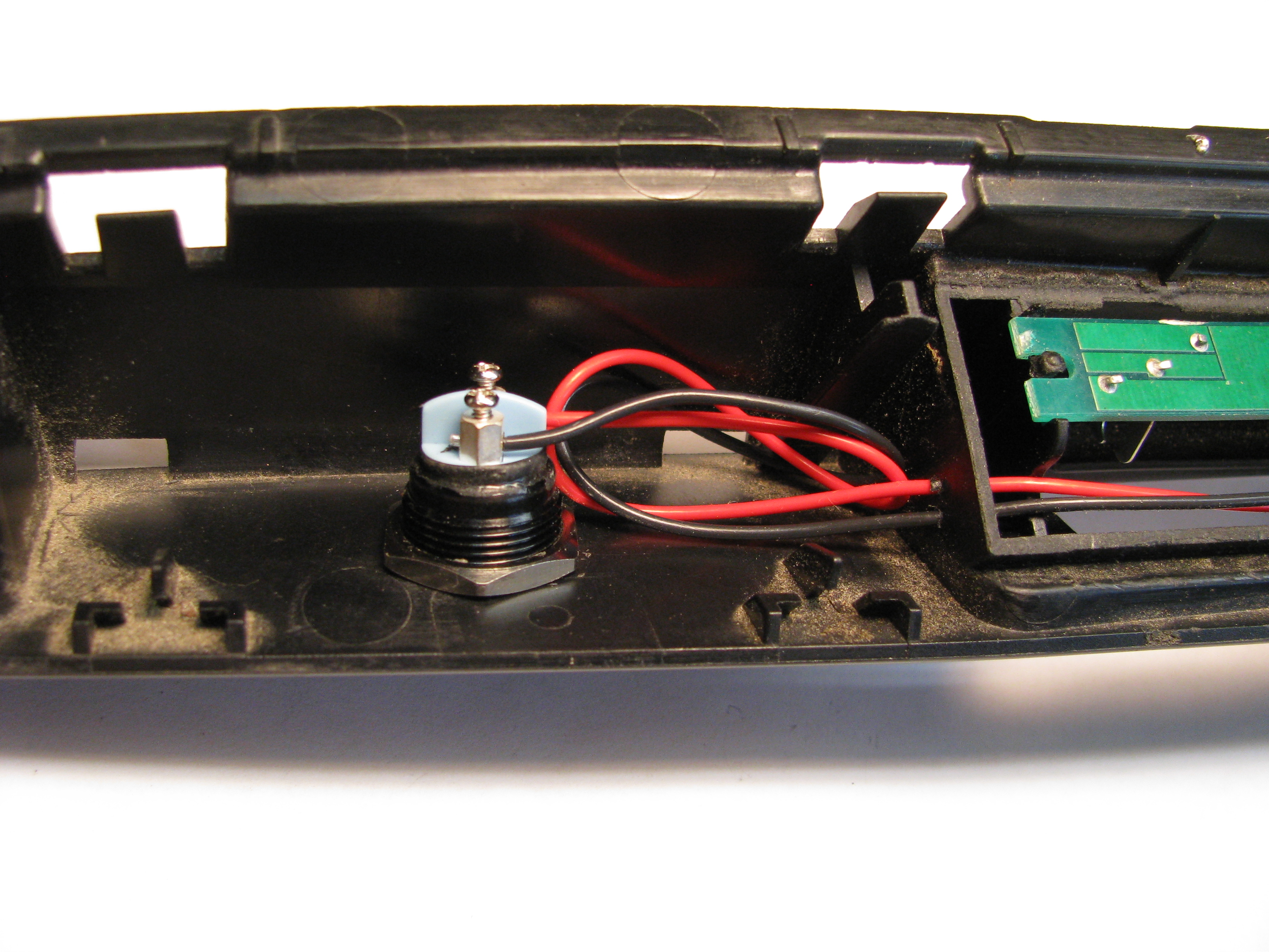

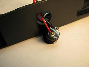

Rear Hatch Switch Alternative
Hello Seaswood.
I had tried to find replacement parts back at the time of my earlier post, but to no avail. However, even if I was able to locate the parts, I'm not sure I would want to end up with the same inferior components that would just fail again in the future. So, what to do? I added a secondary switch in parallel that I feel is better than the original squishy rubber handle. I don't have a photo of the finished product as installed on the car, but I provide here some photos that'll give you an idea of the approach. The switch (found on eBay) is a normally open momentary push button type that's nearly flush with the underside of the plastic assembly on the rear hatch and located left of center. I can obtain a "finished product" photo if you'd like.
I don't remember what I used to glue the assembly back together, but it most likely was Gorilla Glue and many clamps to assure a good seal.
Here's a link to the switch I used (I chose the black color so it's practically invisible when installed against the black plastic of the assembly):
https://www.ebay.com/sch/sis.html?_n...72.m2749.l2658
If the link above doesn't work, go to eBay and search for "16mm Black Stainless Steel Water Proof Starter Switch Boat Horn Momentary Button"
Best Regards

Seaswood, I updated my post to include a link to the normally open momentary push button switch that I used for the modification. In the final installation, I just reach under the left side of the tailgate handle assembly and press the button. Since the switch is electrically in parallel with the original switch, the function to unlock the hatch is identical to the original switch.
You'll also notice that there's "excess" wire folded near the switch. If you study the tailgate handle assembly closely, you'll see there's access to loosen the nut that holds the switch in place. In the unlikely event that the new switch fails, I can loosen the retaining nut without disassembling the tailgate handle assembly again. The excess wire will allow the switch to be pulled away from the vehicle for replacement without affecting the connection to the old switch. But I've used the new switch dozens of times and so far it's been flawless.

Tested new switch wired it worked the original switch in pieces parts of switch missing.
now to glue it all back together.
This was not made to last.
Thank you Tom for advise on switch & correct wiring.

In the 1st picture can you clarify where the non-red/black wires are going to that are soldered? I see 3 others going out of the picture but not too clear what to. I assume they are jumping the contacts. Thanks! I ordered the button and will be attempting this myself.

If you go back in this on page 3 up a bit Tom has a picture of wires 1&3 being used.

I saw that. I was a little confused because it looks like there are 3 other wired in that image going to 1,2 and 3. Wasn't too sure what that was about. do all 3 get soldered together?
