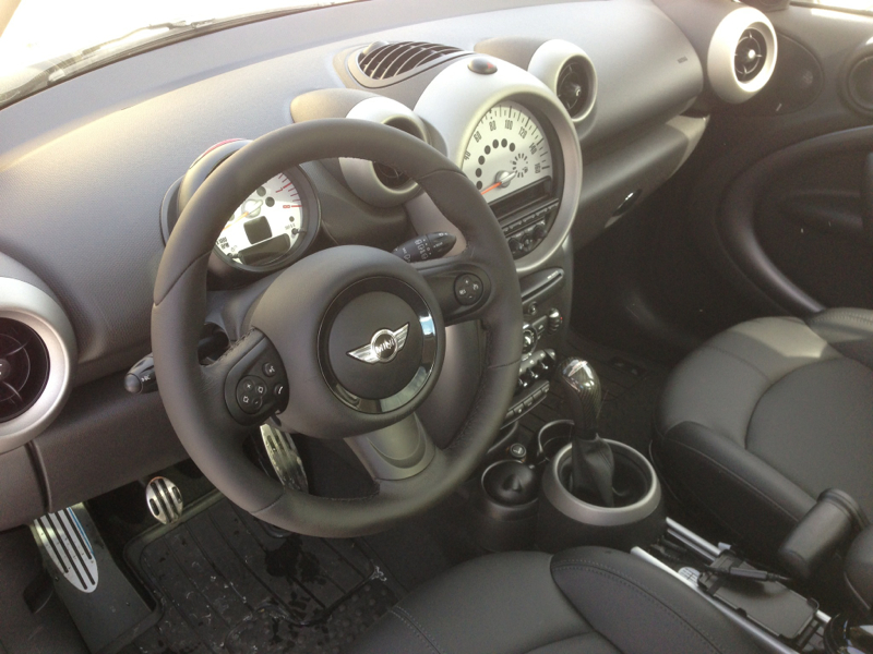

Just wanted say thanks for this write up. Installed me JCW wheel today and these instructions were perfect. Me old wheel was on pretty tight. I had to break out the gorilla wrench with 16 mm socket to get it off. The standard 3/8 ratchet just didn't have the leverage.
Finished product:
Attachment 69867
