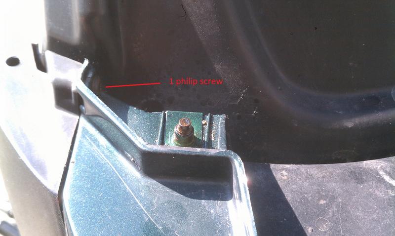

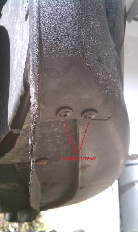

1. start by spraying wd40 on the 3 screws(2 at the bottom and 1 on the top) as shown. The reason is to avoid damaging the screw head in the case its very rusty.
2. unscrew the top screw as shown
3.unscrew the bottom 2 screws as shown

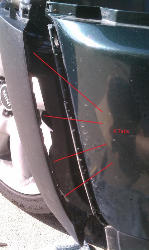

4. hold the fender arch and pull as you are pulling toward the front of the car. be careful not to break any of the 4 tabs as shown

7. push back the fender arch while watching carefully where the 4 tabs will sit in their place
