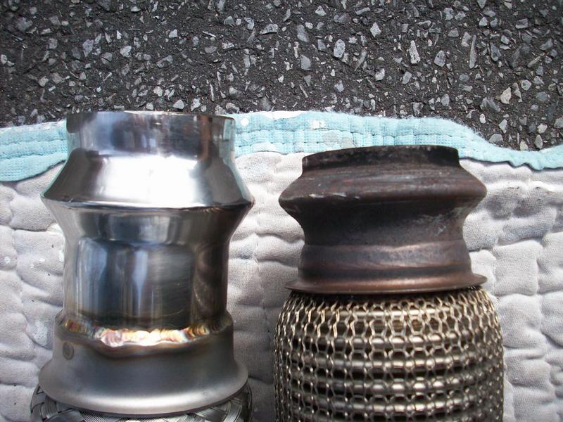

assembled the Q300 side by side to OEM, kept all the clamps loose enough so that the pieces would spin or slide a little if needed...
all looked well...
until we went to fit the Q300 to the downpipe... you'll notice the difference in the length at the point where it fits to the D/P ...
used a Dremel and hack saw to cut it down about a 1/4" ...
hung and clamped the exhaust... tightened all the clamps wit as much human force as possible and started her up...
i didnt reinstall the center plate bc the exhaust was rattling against it at certain RPMs...

Is it necessary to trim that piece? I think mine was left the way it came - I had a local shop throw it on for me.

Mine was the same way. I need to cut it.. In addition, I did notice on their website that the end is much more like stock then ours
But still is too long.. oh well
