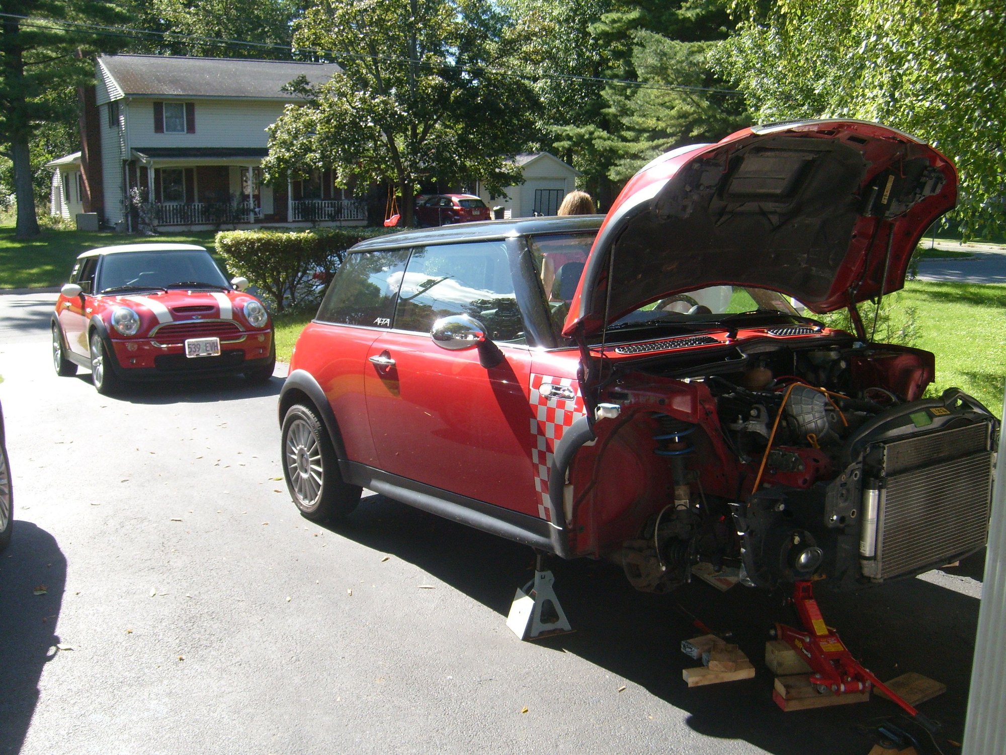

I did the "trans-out-the-bottom" method, so here's an 'obligatory', "here's-my-car-all-apart" pic. (including a friend w/ his '06 JCW, stopped by for moral support - HE has a maintenance contract; what fun is that?):

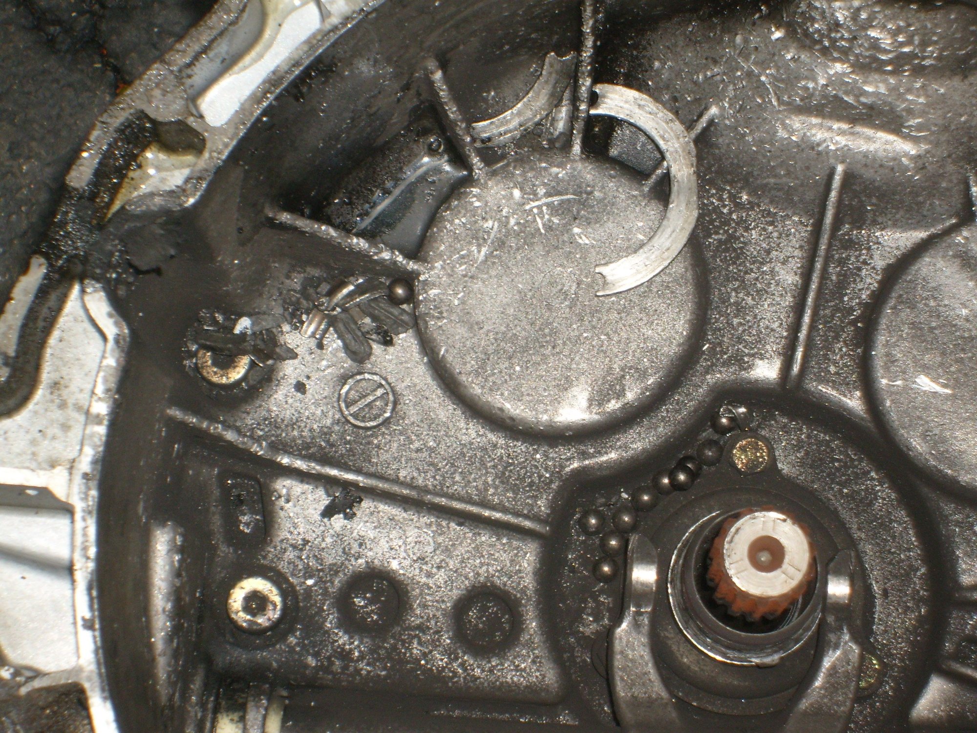

When I finally got the trans bolts all out (and 11-ty hundred wiring connectors disassmbled - thank goodness for digital cameras) I started to gently pry the trans from the engine. Open a ~1/4 of an inch and a ball-bearing fell out. Uh-huh. Continued with the trans removal and saw this:
The release bearing had absolutely "grenaded" - the inside of the "bellhousing" and the PP looked just like somebody had shot it w/ a 12ga shell full of metal shards - a few times. What a mess...actually had to hammer the E8 socket onto the stock pp bolts to get them out, the heads were that damaged.
As part of all the "shrapnel" damage found a 1/2"x1" hole inside the "bellhousing" near where the axle outputs are. Shopped for a used/rebuilt unit, but couldn't afford the $1500 plus, so resorted to 3 layers of JB Weld with some metal mesh (window screen) for extra strength and ground down a couple of the cracked webs.
