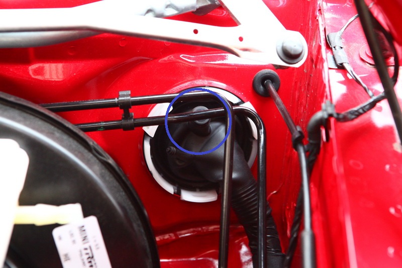

Now, you need to route the wire through the bulkhead panel, follow the main wire harness there is another rubber grommet at the bottom, cut a small hole on it(the space is very limited, you need a small tool to cut) , route the wire through, finally the wire is in the engine bay.
Attached Thumbnails Electrical ::Driving lights installation-img_3105_-.jpg   Electrical ::Driving lights installation-img_3132_-.jpg

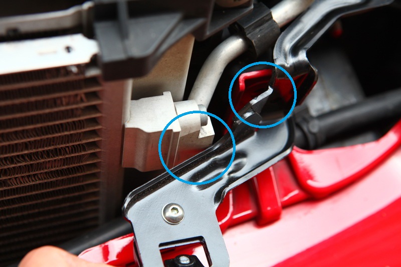

Sixth step, install the brackets. Passenger side was easy. On the 2011 mini, you need to cut the driver side brackets to make it fit, 07-10 is no modification needed. This surprise cost me about 2 hours as I’m short on tools.
Attached Thumbnails Electrical ::Driving lights installation-img_3115_-.jpg   Electrical ::Driving lights installation-img_3117_-.jpg   Electrical ::Driving lights installation-img_3120_-.jpg

Where does the wire come out in the car? Can you see it after you take off the bottom panel under the steering wheel? I know this is old but I wana do my driving lights before it gets cold out. Im adding them since I didnt get that option.
Old Sep 17, 2011 | 07:10 PM
SMOG's Avatar
SMOG
Alliance Member
Joined: Apr 2009
Posts: 661
Likes: 24
From: Port Orchard, WA.
I took the new wires through the rubber boot where the wiring loom goes through the firewall by the brake master cylinder. It is a PITA to get a wire through there without removing the windshield wipers and cowl, but it can be done and small hands help.
jackyiscxd shows the location clearly in the good write up he did.

You can't really "see" where the wiring goes through the firewall. I did this all by 'feel'. Locate the other wiring hareness and follow it up under the dash with your hand..... Eventually you will find the rubber boot as shown in the OP.
I pulled the wipers and cowl when I did mine and then used a wirefish to pull the wires from the inside into the engine bay. I also had help for this step (someone to pull while I guided from under the dash).
