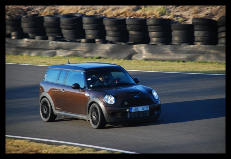

Slinger: Yes, it's a pretty fun track. Lots of sweeping bends so it's pretty quick (not in top speed though). Suits the Mini well, but which track doesn't
Finally the picture upload works! Bad luck last time I suppose
Edit: regarding the speeds at the track, that should be 110 mph, not 70 Miscalculated some, it's 170km/h
Attached Thumbnails Installing Brake Ducts R56-duct-wheel.jpg   Installing Brake Ducts R56-fog-mounting.jpg   Installing Brake Ducts R56-3810_2010-04-25-varruset_201030.jpg

That looks more correct at 110 mph. Looked a whole lot faster than 70 mph to me.
You look like you are still running stock calipers. I am currently running them as well with XP12s but will go to Wilwood sometime soon.
