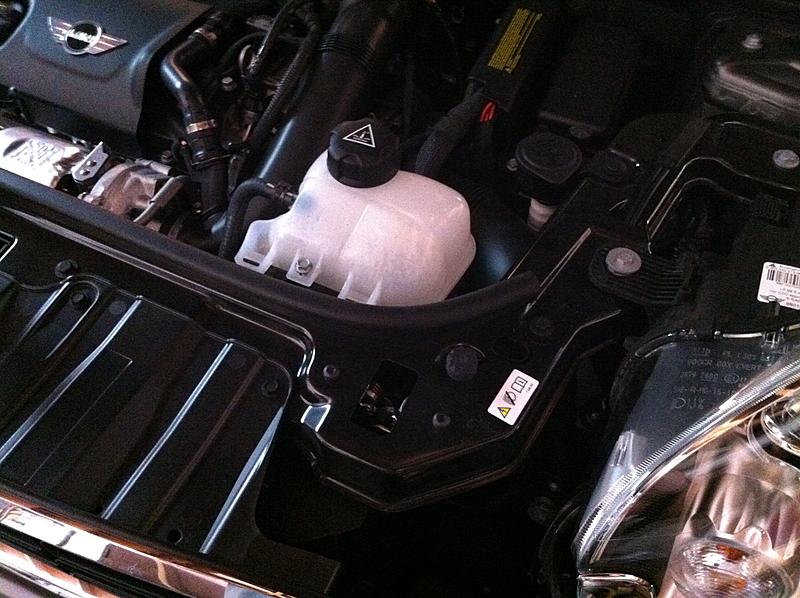

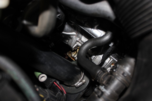

Old May 9, 2011 | 11:45 AM
  #512
Dante's Avatar
Dante
Joined: Apr 2011
A few R60 Countryman S photos
Just in case you R60 Countryman owners wondered how different your change may be. I thought I'd add a few R60 Countryman S pictures to go along with this valuable post. Thanks again to the OP and contributors on this thread.
The oil filter is a little more of a reach with the R60 and the water reservoir doesn't move out of the way quite as far, but it's the same procedure for the oil change.
-Dante
Attached Thumbnails Maintenance :: Cooper S Oil Change (with pics!)-img_1186.jpg   Maintenance :: Cooper S Oil Change (with pics!)-img_1158.jpg   Maintenance :: Cooper S Oil Change (with pics!)-img_1164.jpg
Old Jun 23, 2011 | 07:03 PM
  #513
automan21's Avatar
automan21
Joined: Oct 2010
Posts: 1,053
From: Bx, NY
Yeah same issue here, I tried to move the coolant tank just a bit for my hot side tube install and it started to leak too. I might just try to reach the filter from the bottom.

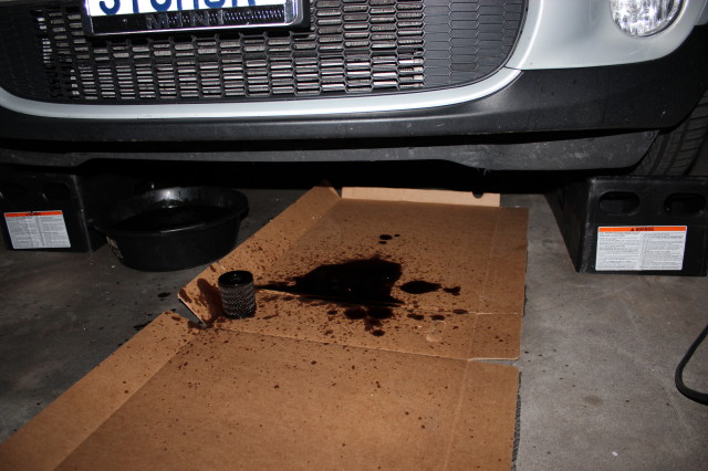

Just did the oil change on the Cooper S and I totally forgot that there's a lot of oil left in the filter so when I unscrewed it and pulled it out all the oil just dropped and made a mess. How do I get all that oil cleaned up? I tried to clean as much as possible with a towel but I would like to spray the area with some cleaner, any suggestions? Something safe for the hoses, wires and transmission case. Thanks everyone!!
Attached Thumbnails Maintenance :: Cooper S Oil Change (with pics!)-img_1646_1_1.jpg   Maintenance :: Cooper S Oil Change (with pics!)-img_1647_1_1.jpg

Oil Filter mess!
Only suggestion I have is to pull the drain plug, remove the filler cap, loosen but do not remove the oil filter cover, let drain, while you wait go see a movie read a book, maybe even write a book. I know, I'm being facetious, but I have yet to pull the filter (4 changes) without having a lot of oil still drip out over everything.
And yes I have waited up to a good half hour, it may be a bit less messy but jeez louise how long does it take?
Any suggestions are welcome.
Seems to be a common experience with the N18. I circumvented the leakage by taking a large syringe and transferring the coolant in the tank to a separate container prior to unbolting it and moving it out of the way. Used a bungee cord to hold the tank out of the way while swapping the oil filter, then replaced the coolant back into the tank as a final step. Adds no more than 5-10 minutes to the total process.
Odd that the lower hose fitting on the tank is so susceptible to leaking when there's lateral stress applied to the coolant hose, but (thankfully) it seems to be tight as a drum in its normal configuration.

I'm working on my 3rd or 4th oil change in my 2007. I got some coolant leakage on that bottom expansion tank connector this time. Freaked me out. I had no issues the other times. It looks like a semi-common issue so I'll put everything back and monitor for leaks. Just to verify, that connector does swivel right? I think I'll order a spare hose just in case. Does any one know the part number? I can't seem to find it on realoem.com.
Old Dec 3, 2011 | 10:41 AM
  #524
Gil-galad's Avatar
Gil-galad
Joined: Dec 2006
Posts: 5,520
From: Decorah, IA
The connector swivels on my '11, and I had leakage from there during my first DIY oil change at 1500 mi. Seems that the hose is a bit shorter on the N18 engine (2011+ MCS) and so it's easier to put a strain on that connector when you move the tank aside to access the oil filter. The lateral strain on the connector is what causes the leakage.
As part of the DIY process now, I take a large syringe and suck out the coolant from the tank before moving it aside. I was freaked out at first too, but over 15K miles I haven't lost a drop of coolant during normal operations. I've safely (so far) assumed that the connector behavior is normal.
Old Dec 3, 2011 | 03:46 PM
  #525
TheCheatOSX's Avatar
TheCheatOSX
Joined: Aug 2008
Posts: 162
Likes: 9
From: Evansville, IN
I ended up doing this too so I could inspect the connector. I popped it off and it looked good to me. It wasn't cracked and the O ring looked fine so I snapped it back on and proceeded as normal. Just a crappy design I guess.
