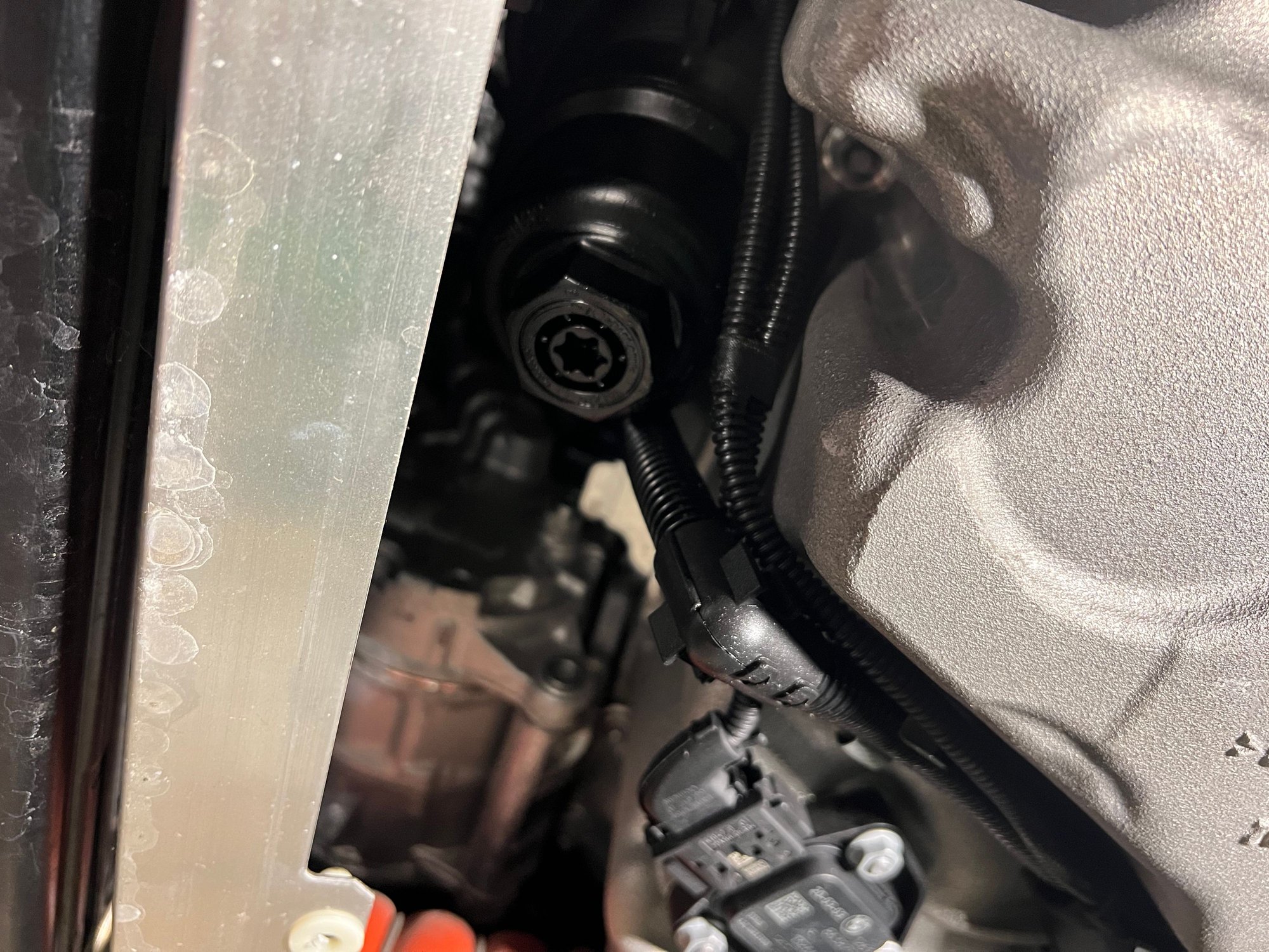

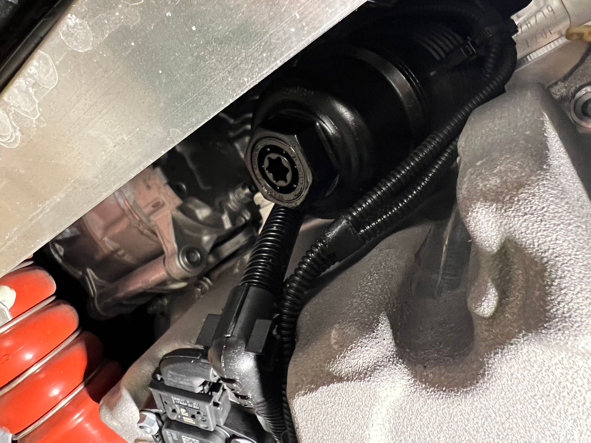

Just finished the an oil change on the GP3. Some things to note:
1) 5.75L is the factory full amount per my service advisor. I used Mini 0w-30 LL-01FE oil.
2) The drain plug is located on the passenger side of the car.
3) There is no engine under tray.
4) You’ll need to remove the half under tray with 8mm screw (7 in total).
5) You will need a T45 torx to unscrew the drain plug under the filter housing before removing the housing.
6) You will need a 32mm oil filter socket to remove the housing and filter.
7) There is additional bracing specific to the GP3 (I believe) that gets in the way of the filter hosing just dropping down vertically. There are also some wires around the filter housing. You will need to unscrew the housing completely then angle the housing toward the passenger side then carefully remove the housing. You’ll reinstall at the same angle you came in (from the passenger side).
Pretty easy job overall.

Just performed an oil change on the GP this weekend. Just like @Hellokitty90 mentioned, it's really straight forward and the oil filter/housing wasn't much of a challenge. Just angle it towards the passenger side and it comes right out with relative ease. I went with LM 5W-40 and a can of MOS2 anti-friction additive. Wife's feedback on driving after the oil change was the GP felt super smooth and noticeably quieter compared to the OE oil that had only 700 miles on it.

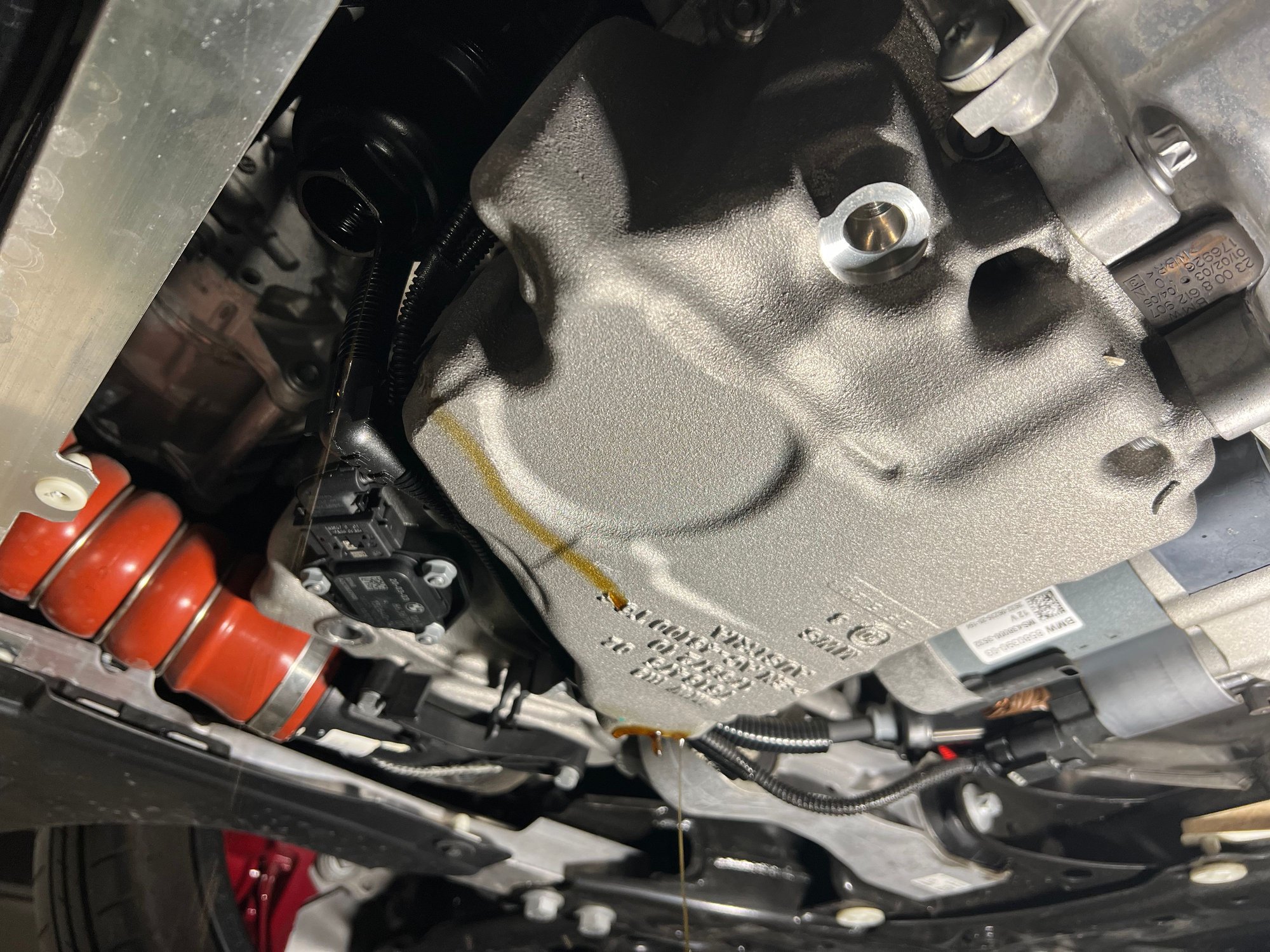

dumb question... curious to know what this drain looking this is.. always paranoid about going bumps and getting it damaged..
Old Sep 28, 2022 | 06:31 AM
RichsMINI's Avatar
RichsMINI
Joined: Jul 2020
Posts: 266
Likes: 166
From: New York State
@benben01, I was told by a Service Advisor it was an drain line for the air conditioning…
After speaking with a MINI Technician it turns out to be the turbo air discharge duct and the part number is 11658605502
Locally there are some large speed bumps I’ve driven over and that part is not damaged.
