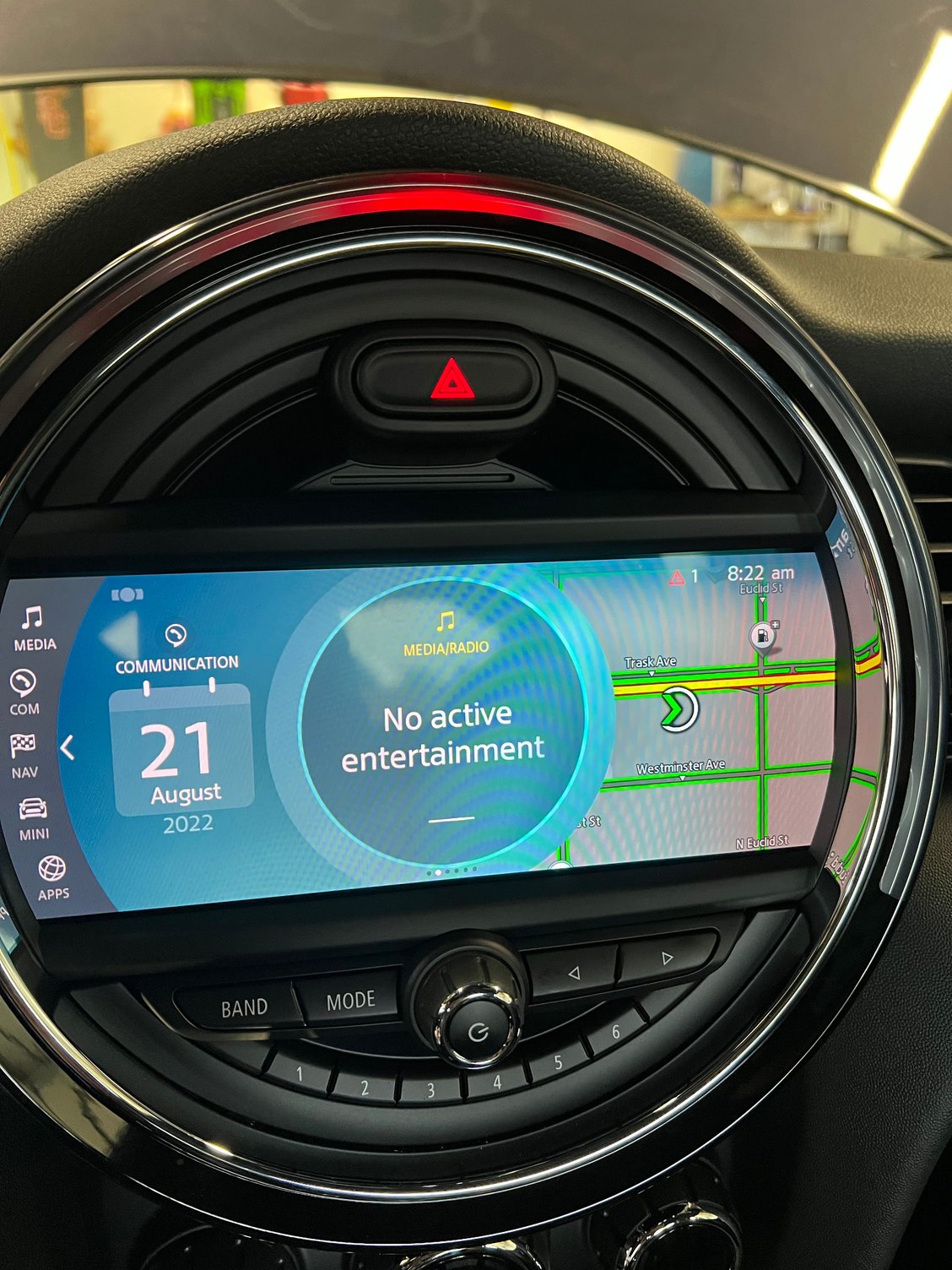

I updated the DME, TCU and NBTEVO (idrive) this morning using the services offered by Bimmer-Remote.com.
I’ve attached some pictures of the process and after. The new iDrive is a revamped version for 2022. Looks much more modern and a dramatic upgrade from the March 2020 version that came with the car.
The transmission is shifting MUCH better. It’s smoother in automatic mode and I think the shifts are slightly faster in manual.
You will want to specifically state that you want all 3 items updated since they are each separate procedures.
They were all updated to the latest March 2022 versions, which is the same as what the dealer would have at the moment. Keep in mind the dealer will likely not perform these updates unless you have a problem or error code. They didn’t want to perform an update for me even though I told them I was going to pay for it.
