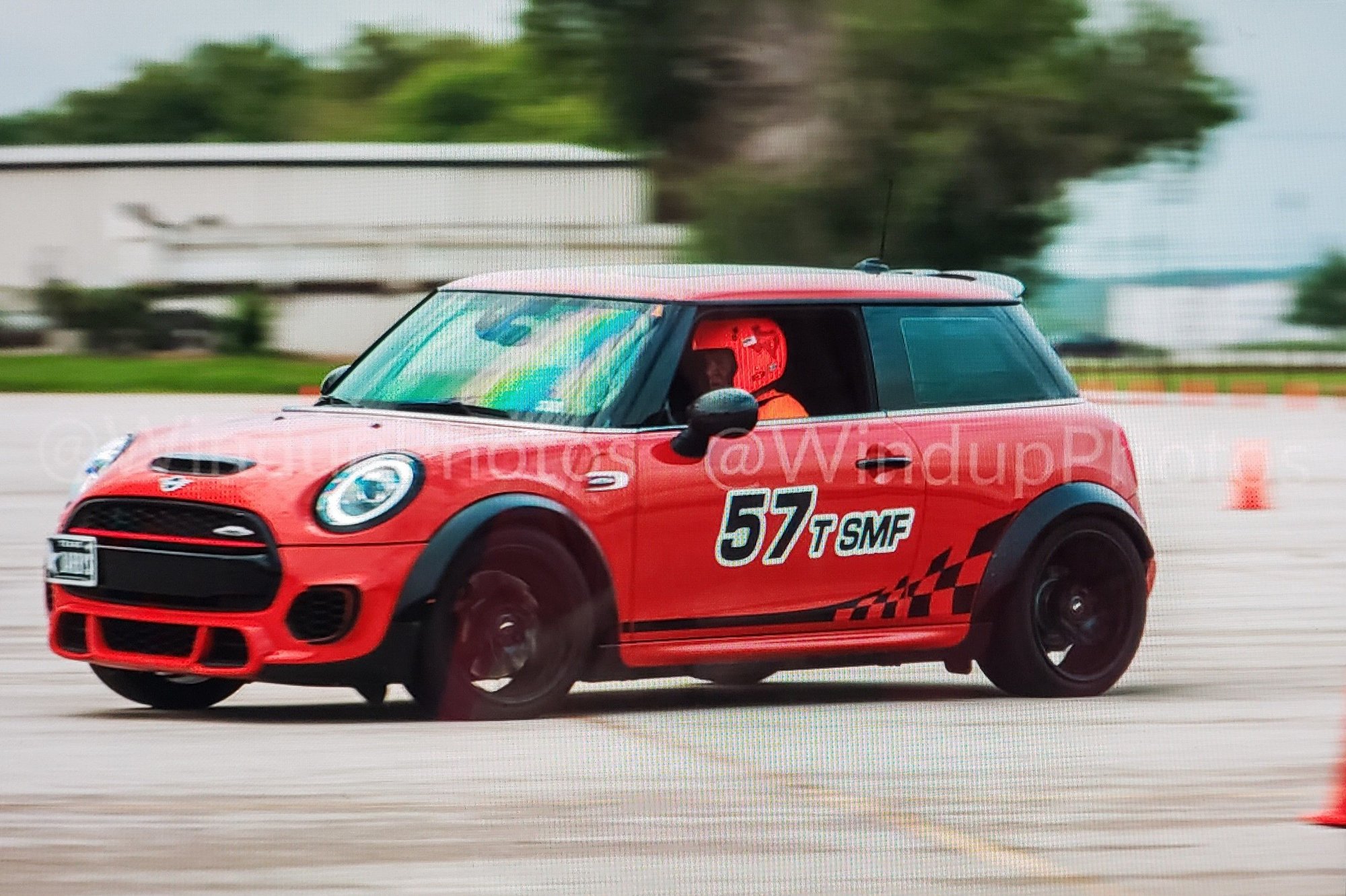

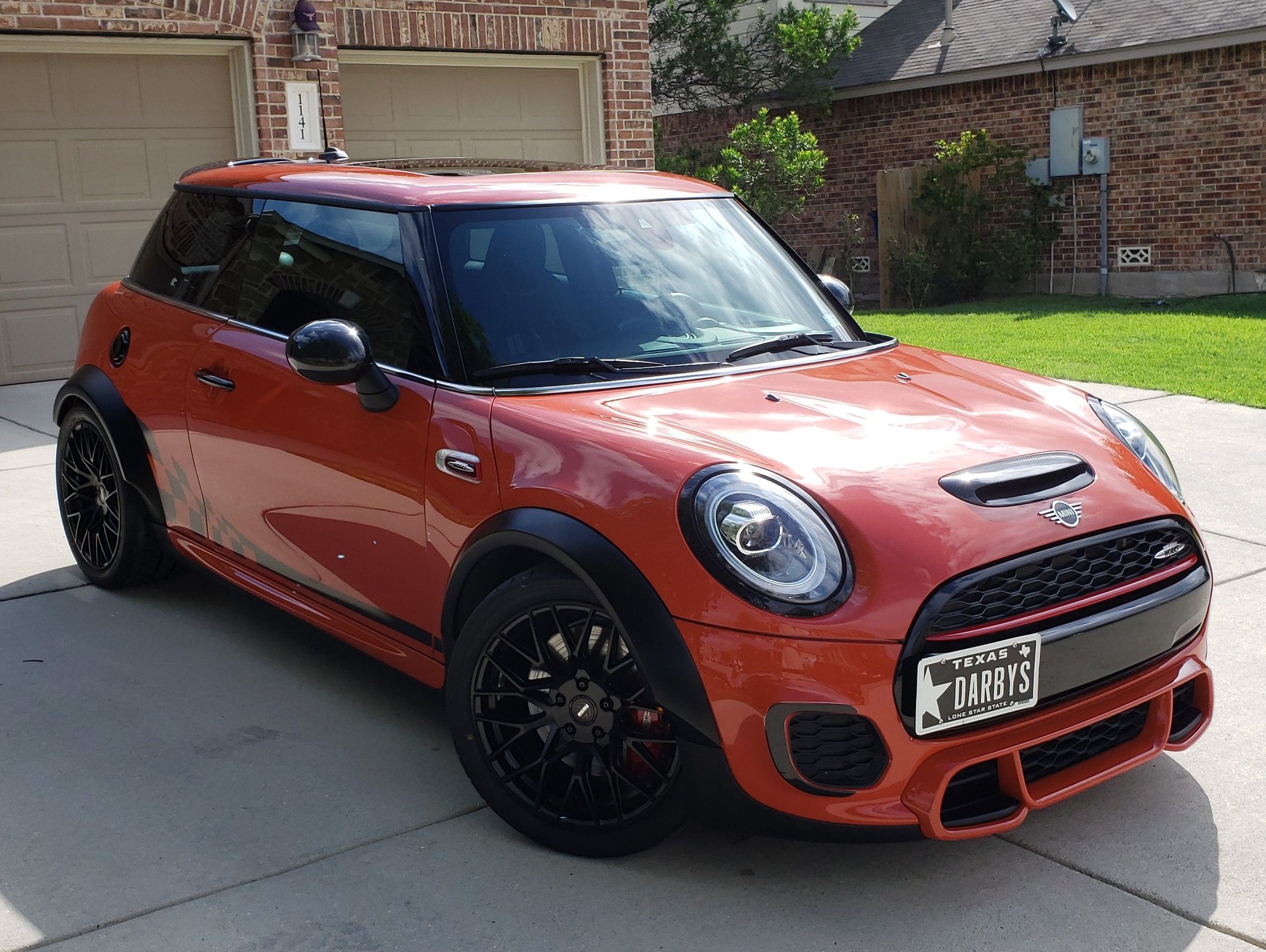

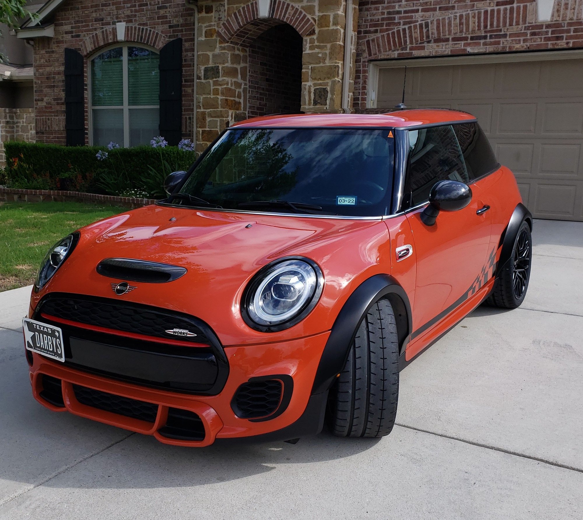

After adding some fender flairs I added 12.5mm Spacers for my 18x8.5 et35 MOMO Wheels with Yoko A052 255/35/18s and it has completely improved everything.

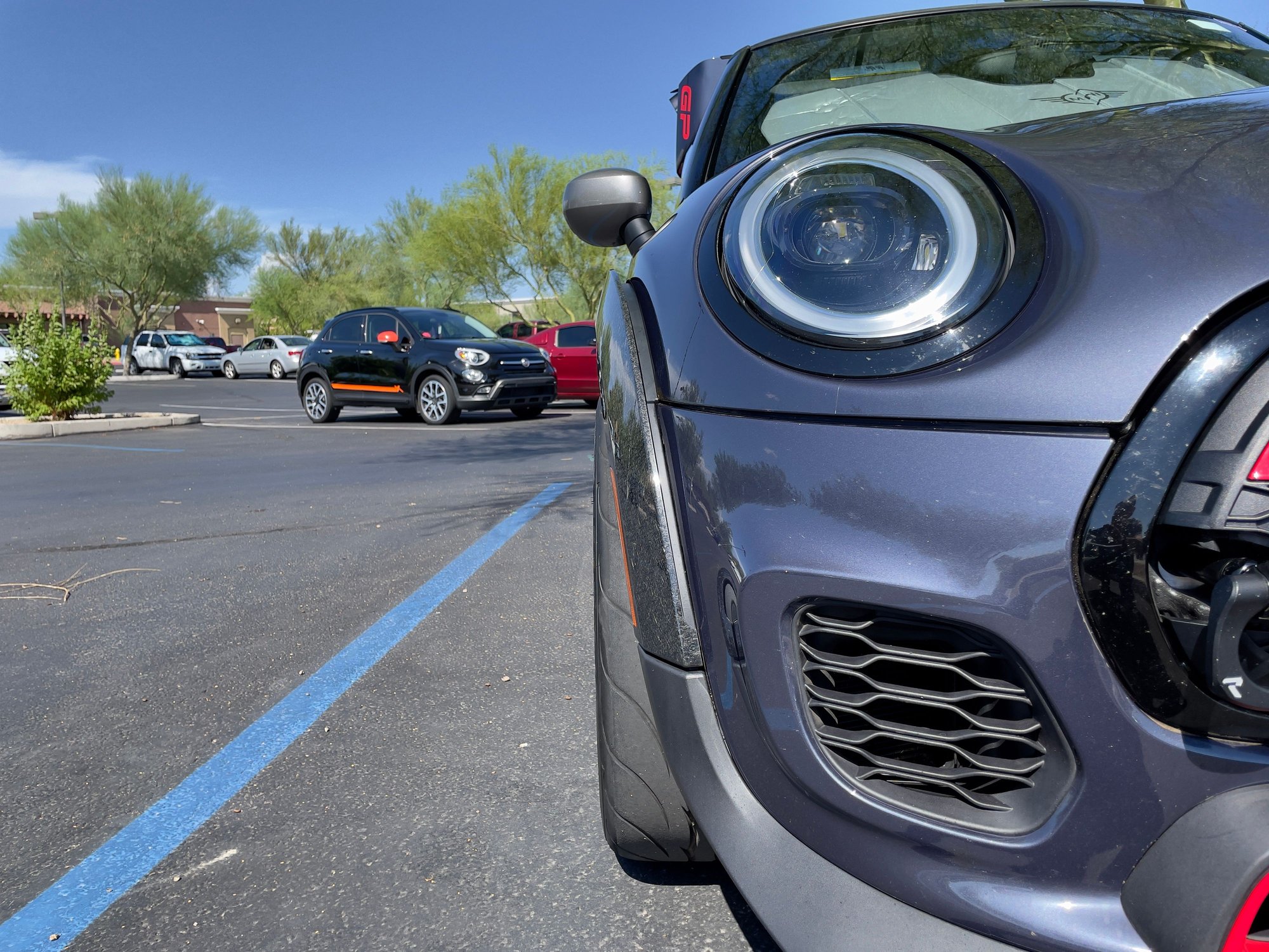

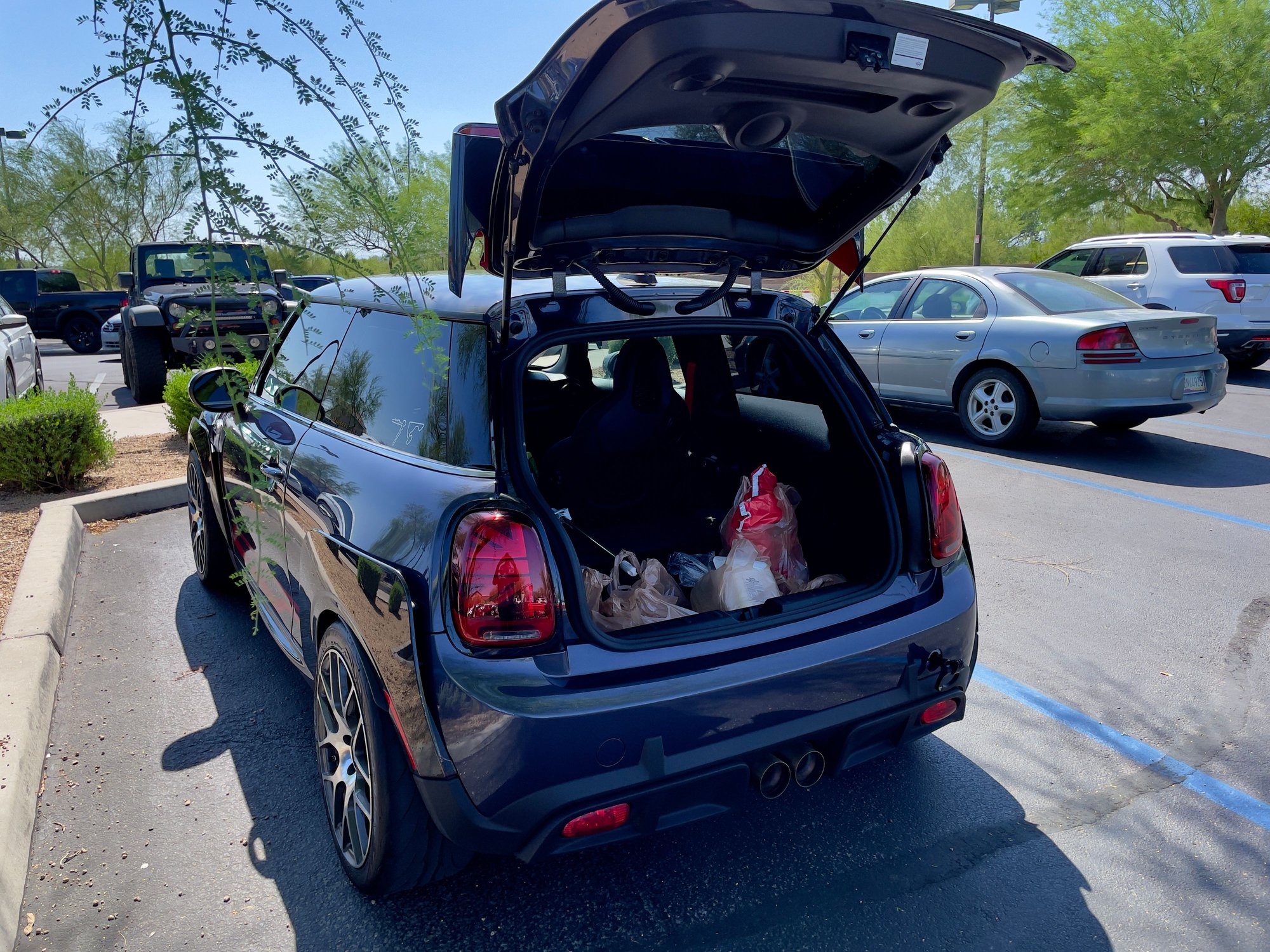

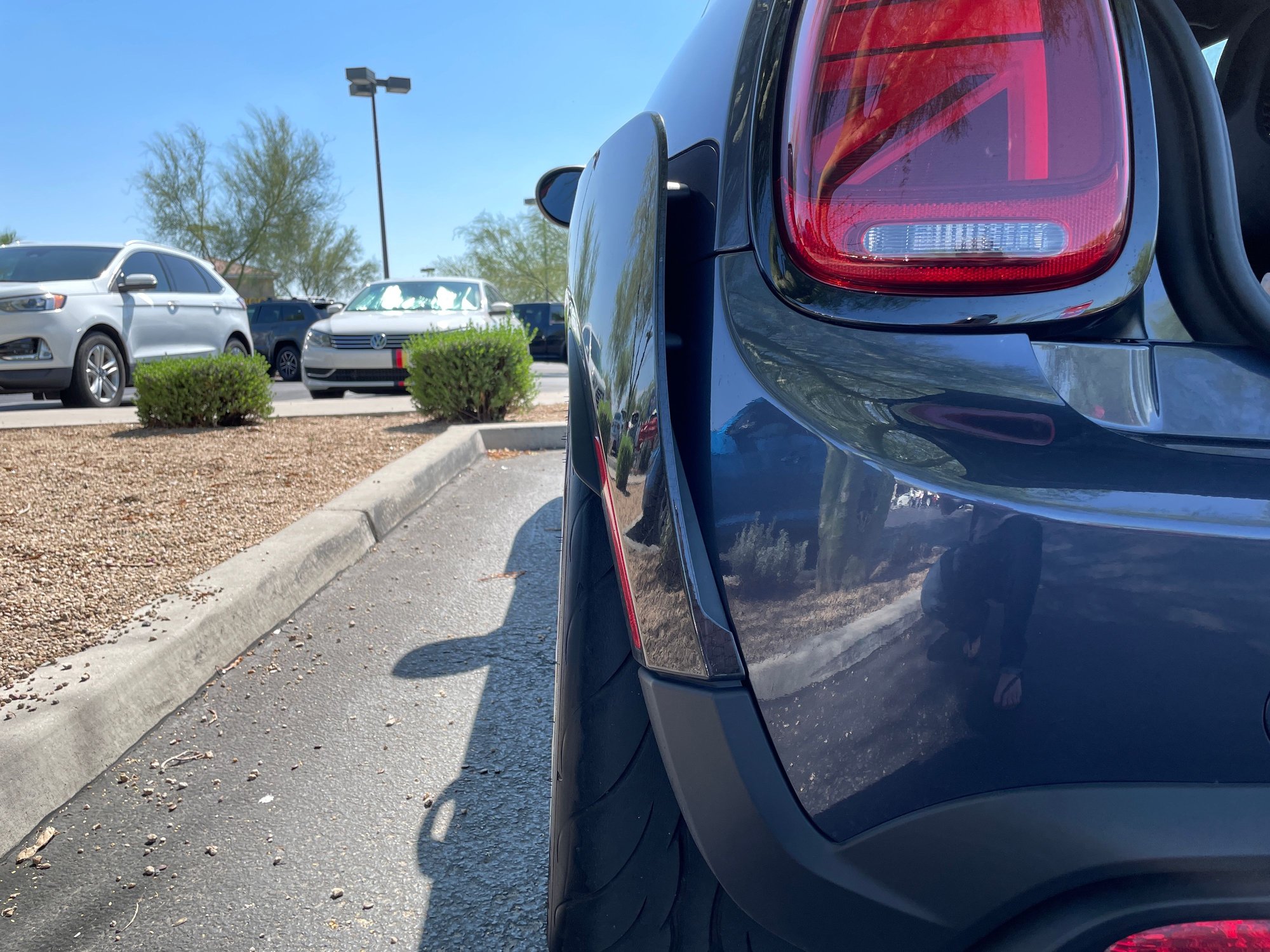

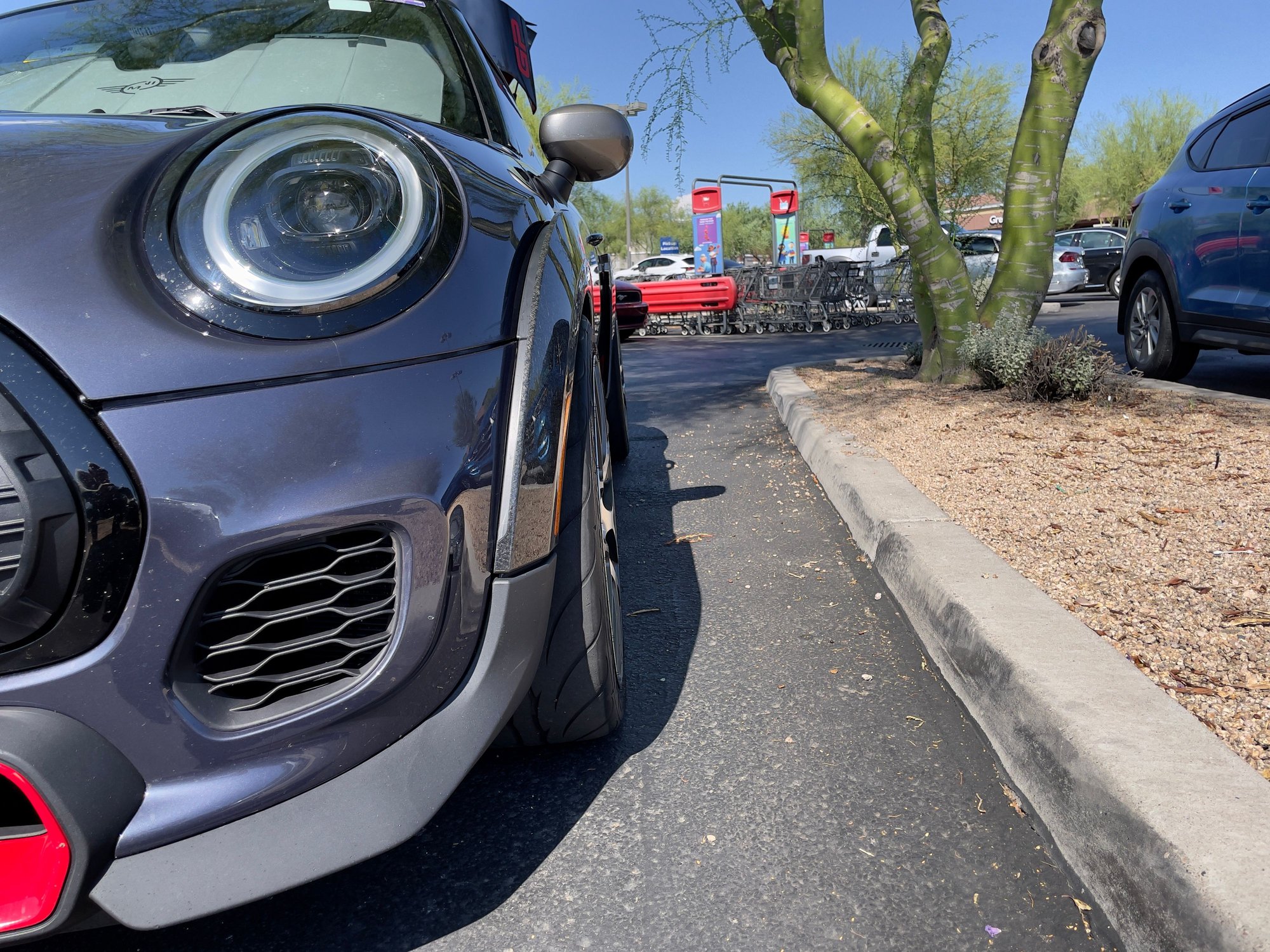

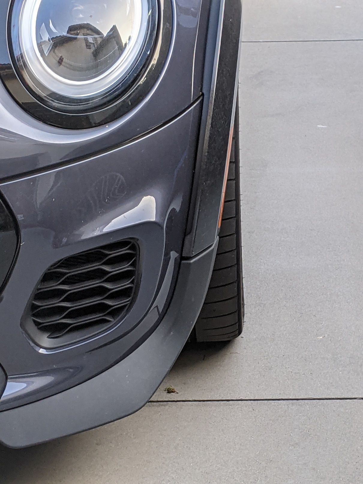

The package came this week and I put the spacers on yesterday. Funny thing, I was putting them on the rears (I had already don't the fronts) and I noticed one of the new bolts wasn't working very well. It felt like it was completely stripped while I was trying to get it in. Turns out, it was the wrong size bolt, both in length and diameter. I was resigned to just having 4 of 5 bolts in that particular wheel when I went back and double-checked the rest to make sure none of them were bad, too. Turns out, the bad bolt was just an extra. Instead of 20 bolts, I got sent 21...the one extra just mis-sized, lol!.
Anyway, everything is on and seem to be working correctly. Here's some pics of 8x8.5 et32 wheels, Federal RSPro 235x40x18 tires with 8mm spacers. With some groceries as a bonus . I haven't driven it enough to comment on any day-to-day improvements, and it'll be a month or so before I can really test it at the track, but...so far I'm good with it.

I have been debating about which size spacer to use and I think after seeing your pictures the 8mm are about right. Anything else would not look as good! I have checked with Bonos and I am going with them. They warned me about the fitment with the 8mm.
This is Wall from BONOSS , glad to receive your inquiry .
As we check , the Mini Cooper have 11~12mm hub height , if you put 8mm hubcentric spacer on it , the hubcentric lip will break . So if you would like to install 8mm , it will need to be non-hubcentric spacer , for hubcentric spacer we suggest 12mm .

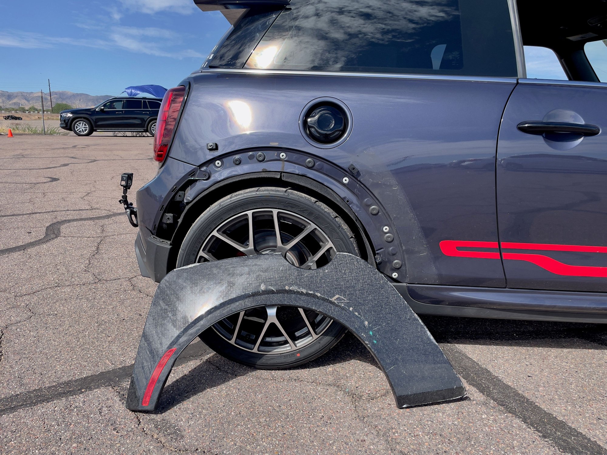

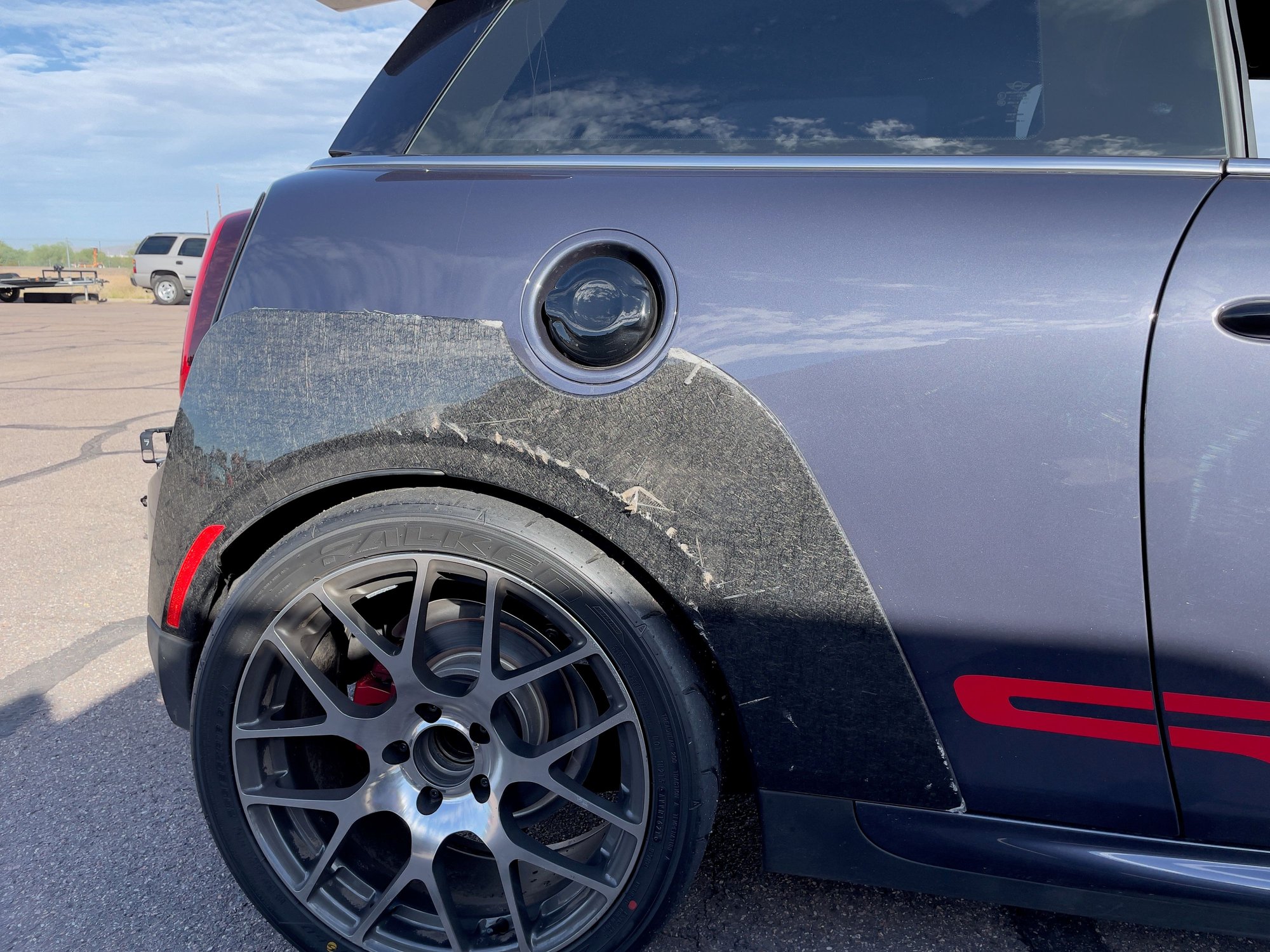

Well, I found out the hard way that 255/35/18 Azenis RT660 tires on 18x8.5 wheels with 8mm spacers is not a good fit for the GP3 and a track, lol! The rear fender got bumped off 2x at one particularly gnarly curb The spacers have come off now and we'll see how just the tire size works on the track shortly.

Takes some trimming of the metal that shows...not a huge amount but I did front and rear and added flairs (Wider than the GPs) and added 12.5mm Spacers with no issues (I am running 2.2 degrees of camber front and 2 degrees rear). I would like to fit some 265/35/18 YOKO A052s Front but am not sure about clearance while turning. The setup as is works very good. I am on 18x8.5 et35 with 12.5mm Spacers all around...

Man, you put 255 on, you don't need any spacer at all, it stick out 30mm compare to stock size.

From 225 to 255 the tire moves 15mm out from each side...The 30Mm divided by 2,,,
You have to see where the tire sits near the struts so there is no contact,,,
As for Spacers, you use them to adjust the et(offset) of wider rims and/or tires...
