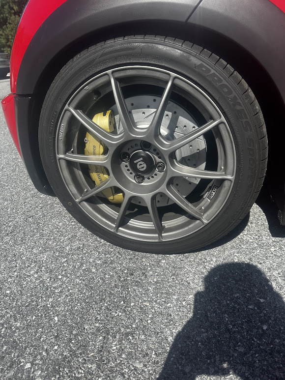

Kind of old thread but I'll add some information here. I got the 6 pot brakes for my r52s this summer. Definitely the pedal feels soft, brakes work but they have a lot of travel if it makes sense. I bought the GP2 master cylinder, but it does not have the port for the DSC and it would not fit. When I feel like it (It might take a while since the car is not my daily and I only drive it in the summer) I will look into trying to make the GP2 master cylinder work.
