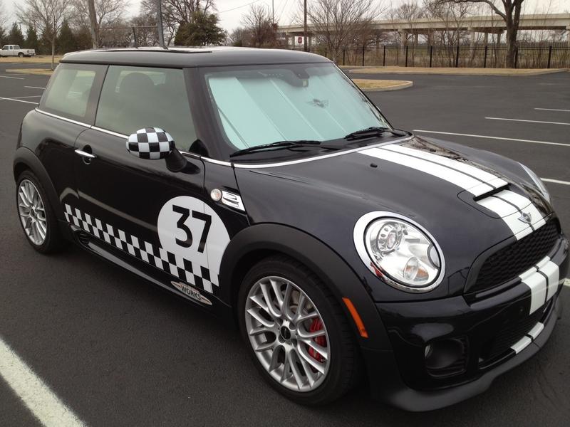

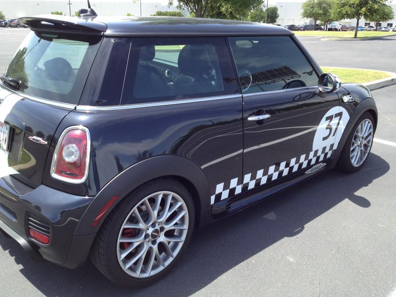

Got it installed today - very straight forward install by the guys at Texas Track Works. They had the old ones removed, broken down, and the new ones put together and back on in an hour. The alignment took about 45 minutes, and then I was off.
Handling difference and ride is definitely noticeable. I'm extremely pleased with the results.
Now I just need to get the GP rear spoiler on, and the transformation is complete.
Last picture is the before shot.

Nice! Looks so much better now that the wheel gap is gone. Looking forward to pics when you get your GP2 spoiler installed.
