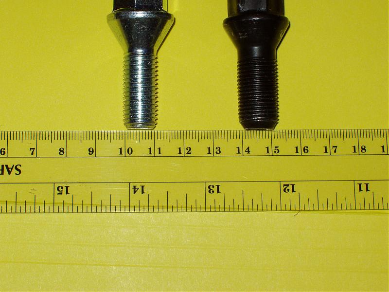

Wheel Bolts
Ok, I have no dial gauge but you will get the idea.
The silver one is from my '02 S
The black one is from my '06 GP (finer threads and larger diameter)

Thanks for the pics. I guess that shows the difference between the 12mm bolts and the 14mm bolts.
I still don't see how this affects anyone's choices when it comes to wheels, because I've seen GP wheels on an older MINI, and wheels from an older MINI used on a GP, both without problems.
I guess the bolt holes in the wheels are large enough to accomodate either size wheel bolt, and the hub-centric fitment and shouldered wheel bolts ensure that the wheel is centered on the hub.

Some wheels (bolt holes) are too small to accept the 14mm bolts.
Do any of the more-popular wheels among MINI owners fall into this category? Most of the websites don't list bolt-hole diameter among the wheel specifications.
Thinking about the SSR Comps, the Kosei K1's, or the various BBS wheels.

Sorry, don't know about those wheels. My OZ Superleggera's fit both though.

SSR Comp wheels will not fit. Bolt holes are to small for new lug. You'd have to line bore them. Or if you want do a butcher job with a drill.
