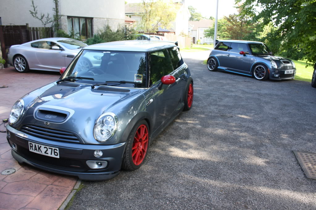

Hi to all....
I run GP1511 and it has been fitted with KW1 coilovers.....amongst many other bits!!
It has been lowered an additional 15mm and have had no trouble at all.....the little flaps under the front have been removed.

Originally Posted by moktabe
Hi to all....
I run GP1511 and it has been fitted with KW1 coilovers.....amongst many other bits!! It has been lowered an additional 15mm and have had no trouble at all.....the little flaps under the front have been removed.
SWEEEET!!!
That 3rd picture looks so good, I never seen a lowered GP like that on stock wheels. It is perfect. Yeah that lip on mine is already scrapping off from the smaller diameter 225/35 tires and the 205/50-15 tires especially. No, really you don't understand, but this pic does it for me!!!
MORE PICS PLEASE!!! Your car is GP ****!!!

Guys, I appreciate what's said about scraping however......I went up to Scotland last week on a GP owners club run. Only 2 cars went, mine and one belonging to a Scots guy who warned me that Scottish roads would possibly be difficult for my car!!
1100 miles later and I had NO problems whatsoever and over 200 miles were on what could be classed as "country roads"......UK roads are generally dreadful and I think the only parts likely to scrape are the 2 little flaps under the front bumper.....mine have been taken off and I have not scraped anything either over speed bumps or general use.
The car only sits 15mm lower than standard so I haven't gone silly with it. The difference with the coilovers and that small drop, the 4 wheel alignment and the corner weighting from the standard suspension set up is like the difference between night and day!!
Go for it if you wish, you may be pleasantly surprised
