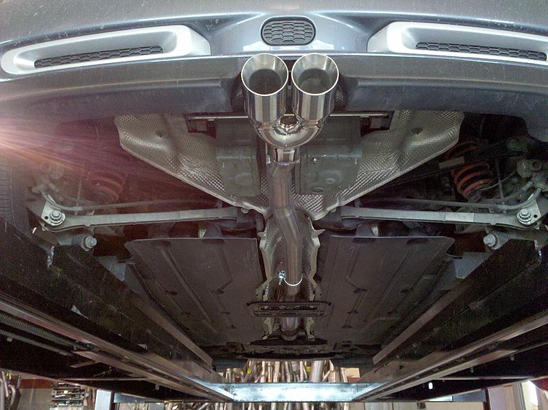

I decided to add a new exhaust and installed a diffuser to enhance the effects of the belly pans. All done with few modification.

First, we cut a tunnel in the batter box to a depth that would allow the exhaust to run through, but not make the box totally unusable. The tunnel is only about 4" deep and is slightly off set to the left. Group 4 will be handling Oddysey batteries and we installed a smaller race battery on the right side of the box. Battery is in a metal jacket and weights about half of the original battery. And later, the fellows who installed the exhaust just bent the exhaust pipe enough to work with the tunnel and exit the facia.
But, this was just a first attempt and found that with a few small bends in the exhaust we could have dropped the pipe a little lower and could have altered the battery box less.
Though, everything worked really well and looks great from the battery box to the new exhaust.

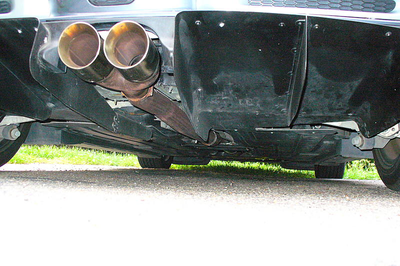

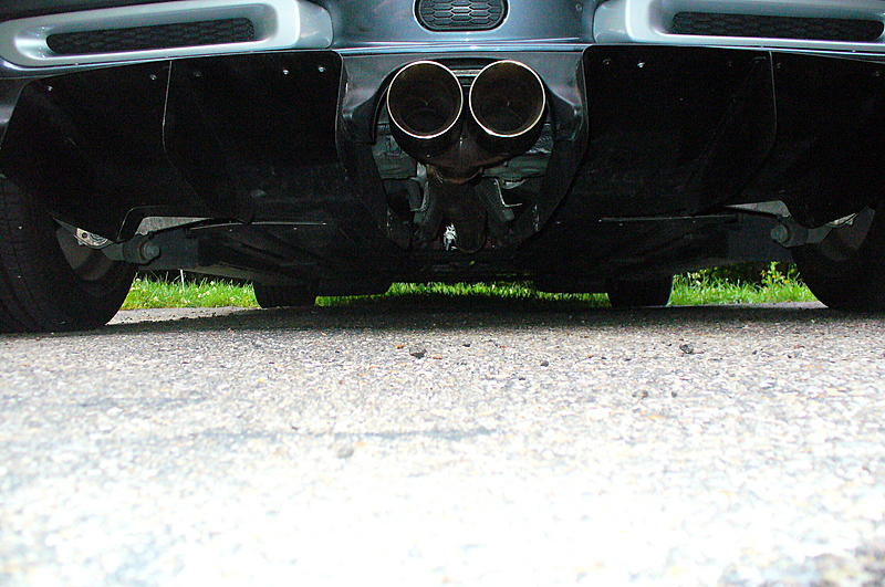

Sorry for the delay, summer got busy early. Here are some photo'es of the Group 4 diffusers that we installed on my GP. They continue the smooth belly of the pans clear through and leaves area for the suspension travel. I took the car out to the track a couple of weeks ago and did notice that the car was more planted in the faster corners or softer apex'es, carried more speed with more positive turn in. So up next would be a Group 4 splitter because of the lighter front now at higher track speeds and better set of tires to take advantage of the better grip produced by the downforce. The car does feel to have more balanced weight with the change in the exhaust and smaller battery in the slower corner.

Does the diffuser make a difference?
My thought had always been that in order to make one work correctly you would have to extend the flat floor most of the way along the bottom of the vehicle although I guess if you just had the rear part of it working it would work properly on the rear...
How does that affect the balance though? MINIs already have a tendency to understeer and if you're putting more downforce on the rear wheels then that would make it even more prone to understeer right?
Third question - how does it affect stability at highway speeds? Getting the nice smooth airflow out from the back has to make the rear of the car more stable. Do you think that would allow you to run a more aggressive alignment settings back there to get more rotation out of the rear without compromising road/straightline performance?

On the track, carrying ample speeds the rear end feels more planted and turn in is more balanced, negating some of the understeer but a splitter would balance the downforce being created on the car. The understeer balance is more in affect in the slower and tighter corners and this is where the straight exhaust and the smaller battery lighten up the rear end making it easier to turn in. With a proper suspension set up or adjustments, you could take more advantage of this. The diffuser works mostly at speeds around 70 to 80mph and above at which time the balance is shifted a little to the rear and the front then will need a splitter to plant the front and balancing the car even more at higher speeds on straights. I believe with the belly pans on the GP, the diffusers affect is apparent at slightly lesser speeds (maybe between 60 and 70mph) compared to MINI's without the belly pans.
On the road, the car is quite more sorted and planted and lane changes are quickly an after thought once committed.
