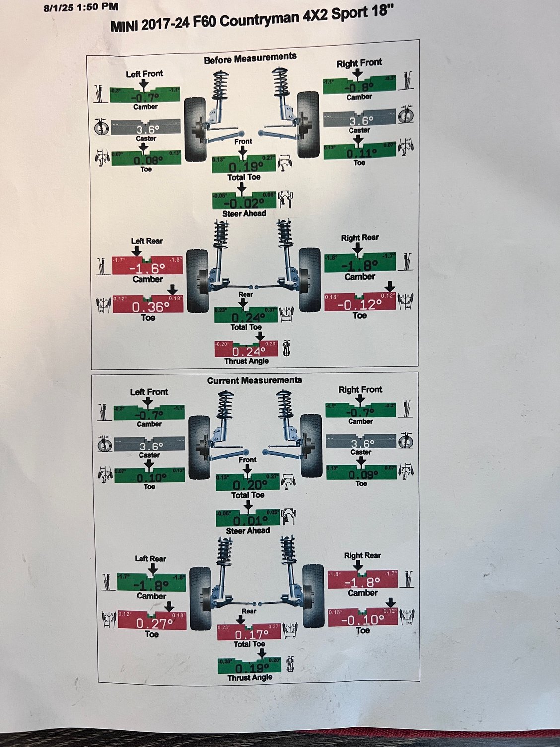

Hello all,
I recently replaced my tires and did an alignment to ensure I'm on a good start. My front looks great given this is my first alignment since 2019. However, my rear toe is off quite a bit.
Does anyone know what to replace or look for to fix this?
Thank you!

Looks like your alignment guy did a decent job! Rear toe is adjustable, but it’s not a trivial task. The rear trailing arm front bushing mount is slotted to allow for some toe adjustment.
You can see the slots on the bracket here:
https://www.ecstuning.com/b-genuine-...t/33326896991/
The mounting bolts need to be loosened, and the bracket adjusted.
