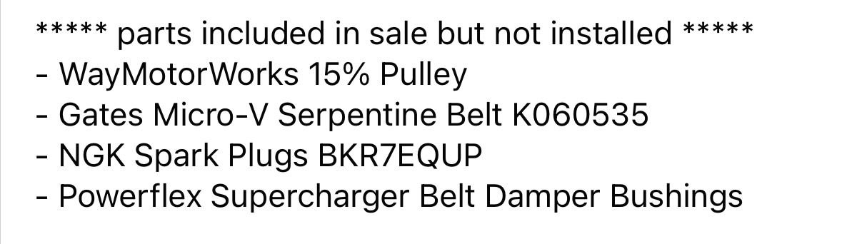

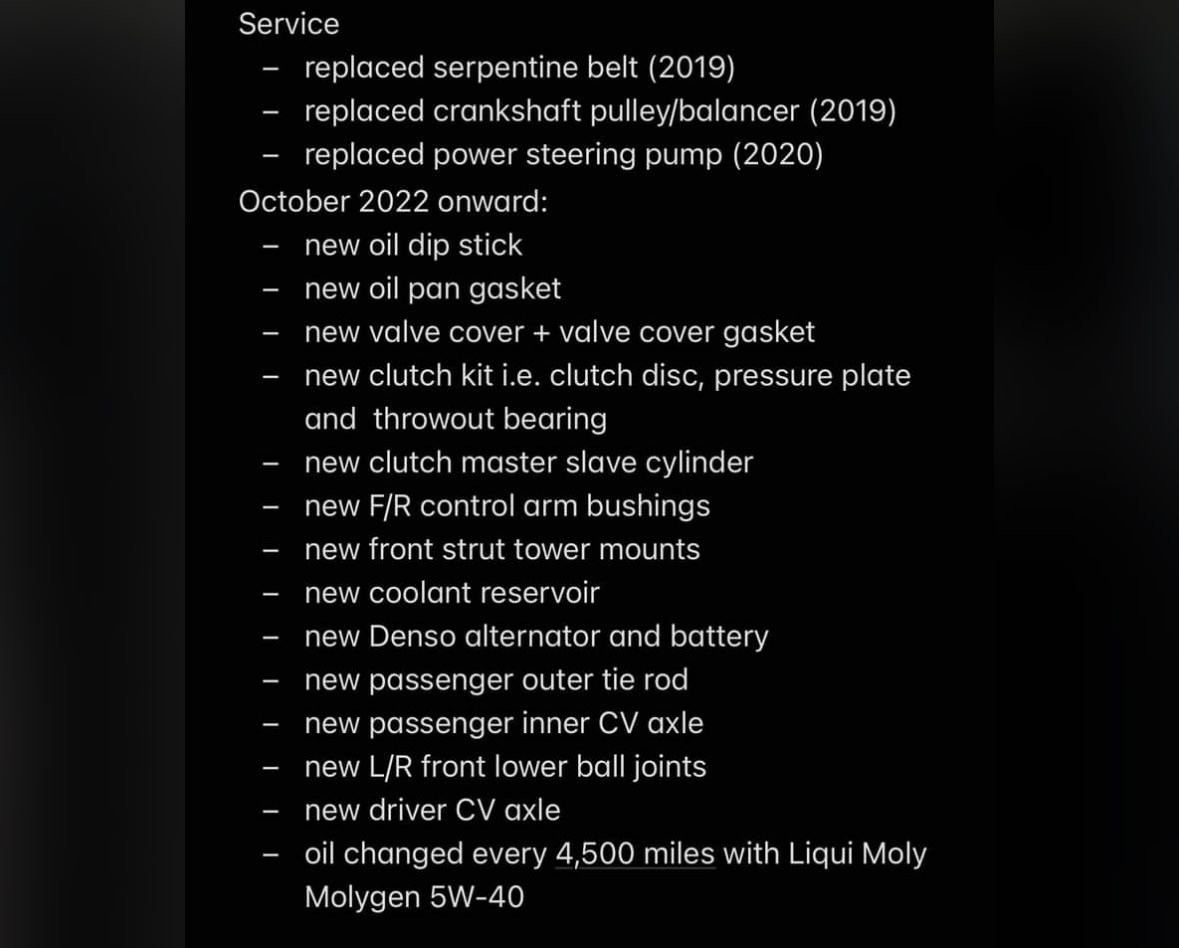

I’m looking to buy this 2006 s,manual,clean title,97k miles.The owner has a ton of service records with receipt's.Hes asking 6500$.can you guys please tell me what you think if this seems like a good buy.going to go check the car out in person in two days and drive it.from what the owner has told me the car is bullet proof has no engine lights and runs flawlessly(unconfirmed taking the owners word for now)from the pictures I’ve seen the exterior of the car is 8.5/10.let me k ow what you guys think based on the services done and the list of parts installed and the ones uninstalled.thank you

Looks reasonable, with a lot of mods. A new clutch is a big spend item.

Lots of nice aftermarket additions but I would expect at that price for the outside to be at least 9/10. At 97k you're at the supercharger service recommended miles. I would also be curious why he has 380cc injectors and a CAI but never installed the reduced supercharger pulley since that one item would provide the largest HP boost. It could be that the owner was waiting to service the S/C (not simple) to install the pulley. Be aware that installing the reduced pulley will require a tune (additional cost) for optimal performance. Touch base with member "adriancl" on this forum for remote tuning, advice and pricing. A final note: If you're unable to work on this Mini yourself, the service and repair costs will be punitive.
