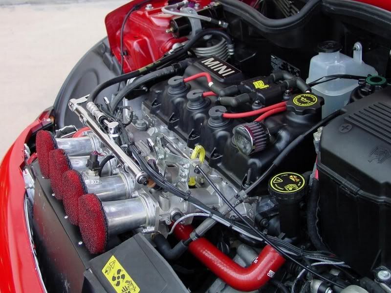

Build the R50 with IRTBs
https://www.northamericanmotoring.co...ml#post4525922

Not sure any motor swap is going to be cost effective....
If cost is a big factor for you, and you drive 40k miles per year, I would pull the engine and do a full tear down and blueprint rebuild, new clutch kit, and have the gearbox refreshed. Update all the suspension rubber bushings with poly, replace all ball joints, all new struts, and enjoy another 10 years of driving fun.
Fun doesn't have to be fast.
