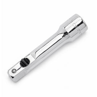

Get an extenion that has the lock side to the little ball, is it 3/8"s drive? You can push it down in and see if the extension can lock onto the socket, sears has them they are craftsman quick release. They seem to really hold.

For anyone who can't find one of these extensions, there is a poor boy trick that I use. I use a little bit of duct tape and tape the extension and socket together. I have never had an issue with this method in all the years I have used it. However, now that I know that extension exists, I may have to try and locate one!

Another option is to take the rubber insert out of the socket, just be careful when tightening up the plug .......I also use a piece of rubber hose to put on the end of the new spark plug when starting it into the cylinder head to avoid cross threading a plug into the head
If you use the socket without the rubber insert, the socket will come right off when you pull the extension out......I have still had sockets stick on the plugs when using the Craftsman locking extensions......
