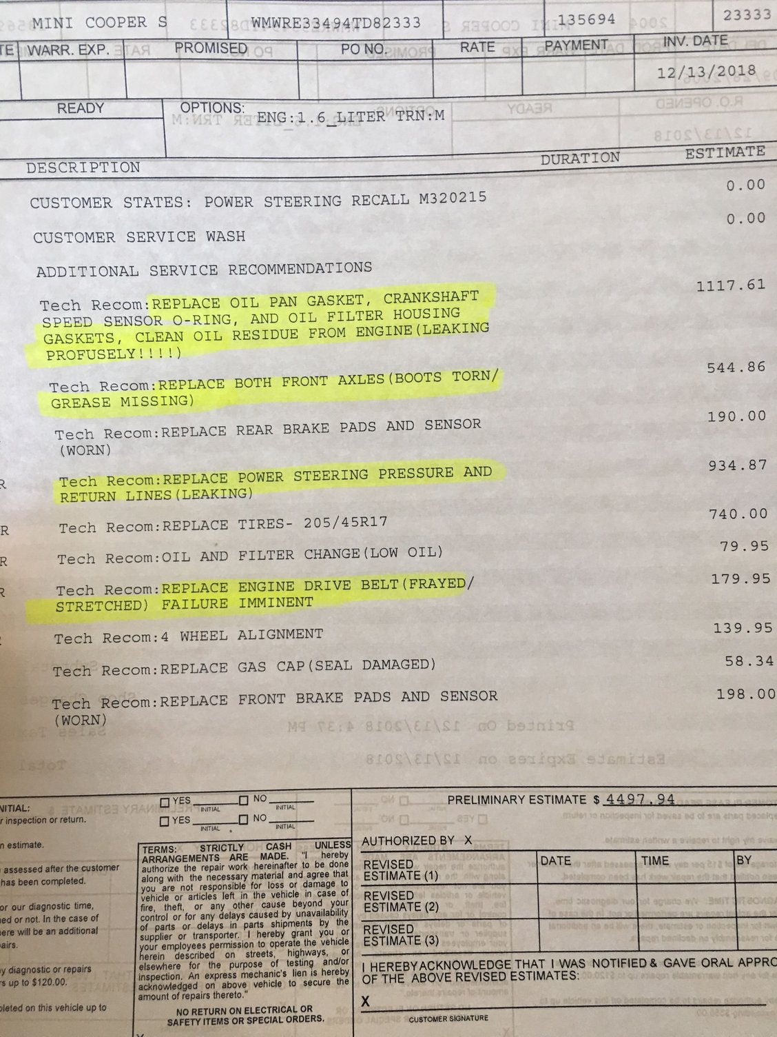

Yea most of it I do need to do but they are so over priced it’s crazy here’s the list of interested and as far as the small things like tires and brakes I already have that planned p.s. my oil leaks are only using 1 quart between oil changes so it’s not as bad as they make it seem but I will fix them all

FYI; In regard to the insane $934.87 power steering line replacement quote, they have to disconnect both of the lines to do the recall pump replacement, so they’re really screwing you on the price of that particular job.
Back when I did the recall on my car, I instructed the dealer to replace both my lines since they had them off the pump. They told me it wouldn’t cost much as they were “in there,” but later tried to bill me $349.00. I protested and got them down to a much more reasonable $179.00.
Most of those repairs on the list are fairly easy DIY if you’re handy with a wrench.

1100 dollars for the oil leak is highway robbery. The car needs to go into kinda front end service mode to get to the oil pan and cps. It took me all of 40 minutes the first time. Once it's there the cps is one bolt and the oil pan is: 4 engine mount bolts, 3 ac bolts, and the oil pan/bell housing bolts. If you have jack stands and like 3 sizes of sockets it should cost you maybe 100 bucks since you'll need new oil.
190 dollars for a serpentine belt is the biggest scam ever. The bmw part is 27 dollars on pelican parts and has to come off the car to remove the ac compressor (to do the oil pan). That's either the best margin for a part of all time or they're trying to charge you labor for the 30 seconds of removing the belt twice.
Fwiw, I had a slightly worse oil leakage issue than you. I replaced my oil pan gasket, valve cover gasket, and cps o ring. I intentiainten didn't do the oil filter gasket out of fear of breaking/warping the housing since it's crazy expensive. My oil leakage has pretty much ceased to negligible between changes

Jesus.
$180 to replace the belt.
$400 to replace the brake pads.
$550 for the axles.
$1,100 to drain the oil and replace some gaskets. And they still want another $180 for the actual oil change.
Apparently, I'm in the wrong line of work.
Go watch some Mod Mini videos, bust out the toolbox, and you'll be able to fix almost all of this yourself for a fraction of the price.

Wow thats al lot.
PS lines are here with DIY: https://www.northamericanmotoring.co...placement.html
Then get the pump replaced. When they first replaced my pump (circa 2009) they did not do the lines and when the pump was finally recalled, they checked mine and found the pump had been updated(from 2009), I did get a check from MINI for the old pump and used that for mods and parts here at ECS.
Most of that stuff you can do yourself and save $$$. When I see most MINI service per hour the same rate as rolls royce (at some dealers that share the brands), I shake my head.

Its an interesting list from my perspective as I get to see what I have potentially saved by working on my own R52. Since getting my 2005 in the summer Ive changed out axles and tires and am about to do brake pads, For information purposes my cost to buy the parts was:
Both front axles $180 (ECS tuning), plus 2 qts R-P Syncromax ~$30 (Pep Boys)
Two 205/45R17 BF Goodrich Comp 2 tires $240 inc installation (Pep Boys)
Front and Rear Akebono brake pads $88 (Amazon/Premier Auto Parts)
Front and rear pad sensors $11 (Amazon/Import Parts Depot)
