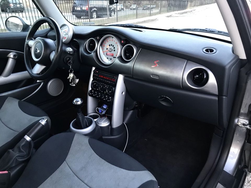

Is the attached image pre- or post- facelift?

See this: http://www.motoringfile.com/mini-r50r53-buyers-guide/
Your photo is pre-facelift.

Easiest ways to tell - the steering wheel and the tail lights.
Pre Facelift had 2 spoke steering wheel. Post had 3 spoke.
Pre Facelift had backup light down near the exhaust. Post had backup lights in the tail light assembly (and backup light from Pre Facelift was changed to fog light).
