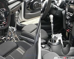

$1039.00 from ECS.
Attached Thumbnails Coolerworx shifter-1035835_x600.jpg   Coolerworx shifter-1035833_x800.jpg

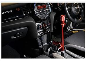

These pics are from someone’s build on another forum. You can see the shifter fits in the well retaining the cup holders.
Attached Thumbnails Coolerworx shifter-00a2f72b-095f-4462-b388-f2c3ab1abb50.jpeg   Coolerworx shifter-4e1dd24f-8dd7-4596-be73-0ae64be5dbd6.jpeg   Coolerworx shifter-7e7ca875-f99e-4db0-ba17-d571d480ece8.jpeg
I am not familiar with this model year. It does appear to me the installer may have shifted the cable box and hence the entire shifter rearwards. You have to scrutinize closely to see it. You may be able to do this as you no longer use the OEM plastic cable box.

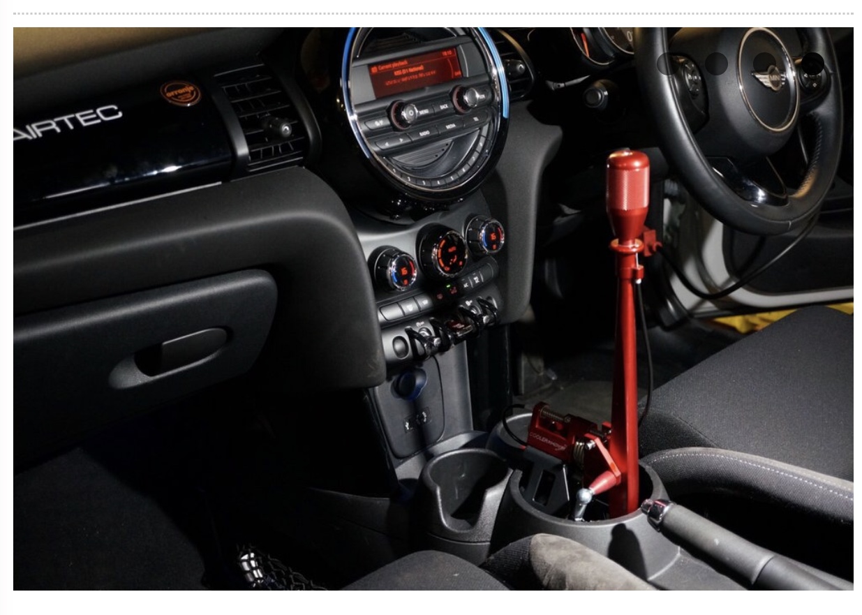

An advantage of the 3rd Gen cars is we don't need the box covering the shift linkage because it's all under the console. When I installed a CS short shifter on my R56 i had a cover made by Detroit Tunes (I think) installed to protect the linkage.

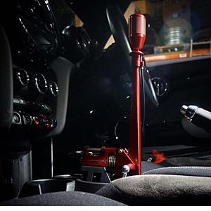

BTW, this photo does not show the more severe angle of the cable, which happens when the shifter pushes the cable to the other direction

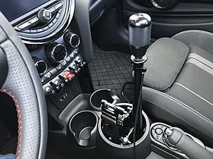

With the CS adjustable short shifter all the linkage connections are within the console. I wish I had taken pictures when I installed mine. The bracket that the pivot point is mounted to is raised about 1/2 to 3/4 inches with bushings which keeps the angles consistent between stock and the CS. Also have a precision two piece metal pivot clip to replace the nylon unit. The combination of the CS shifter, Pro Clip, and S4S Billy Club **** works very well for me. I do like the CoolerWorx, but as you said, the price and hacking of the console required turned me off. That and the fact that I already had the shifter installed before discovering the CoolerWorx.

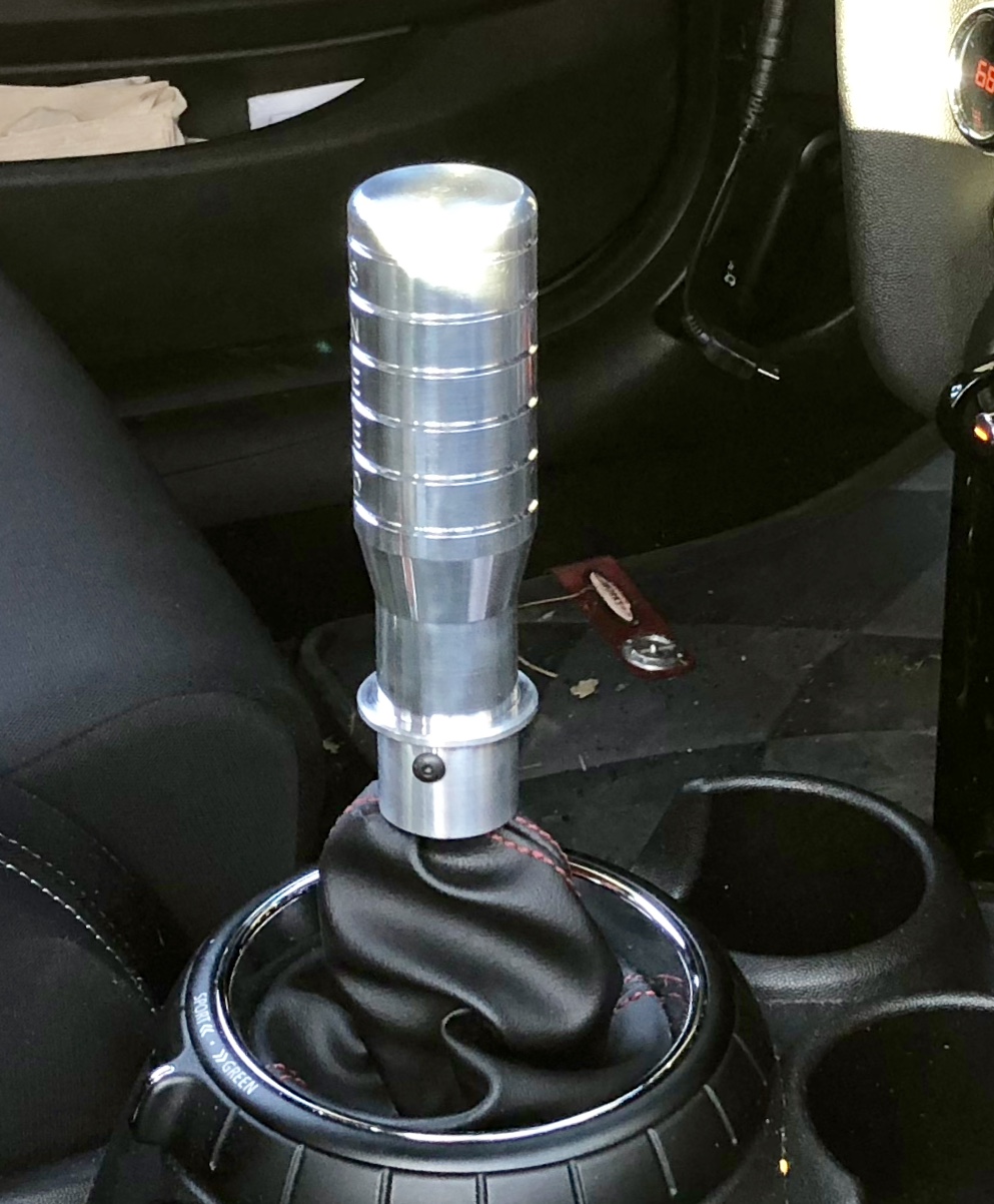

Here is a quick pic of the shifter installed on my ‘18 JCW Hardtop. I didn’t attach the reverse lockout cable yet as I am removing the console one more time to more the shifter forward. It is all the way back now and I think best fitment is 1/2” forward more. No major surgery I just had to remove he ring with he tabs for the chrome ring.
Shifts awesome btw in case anyone was wondering. I’ll post a final pic when it is all back together.
Attached Thumbnails Coolerworx shifter-15fc0852-043b-4b1d-a083-e0a5a3e720f4.jpeg
