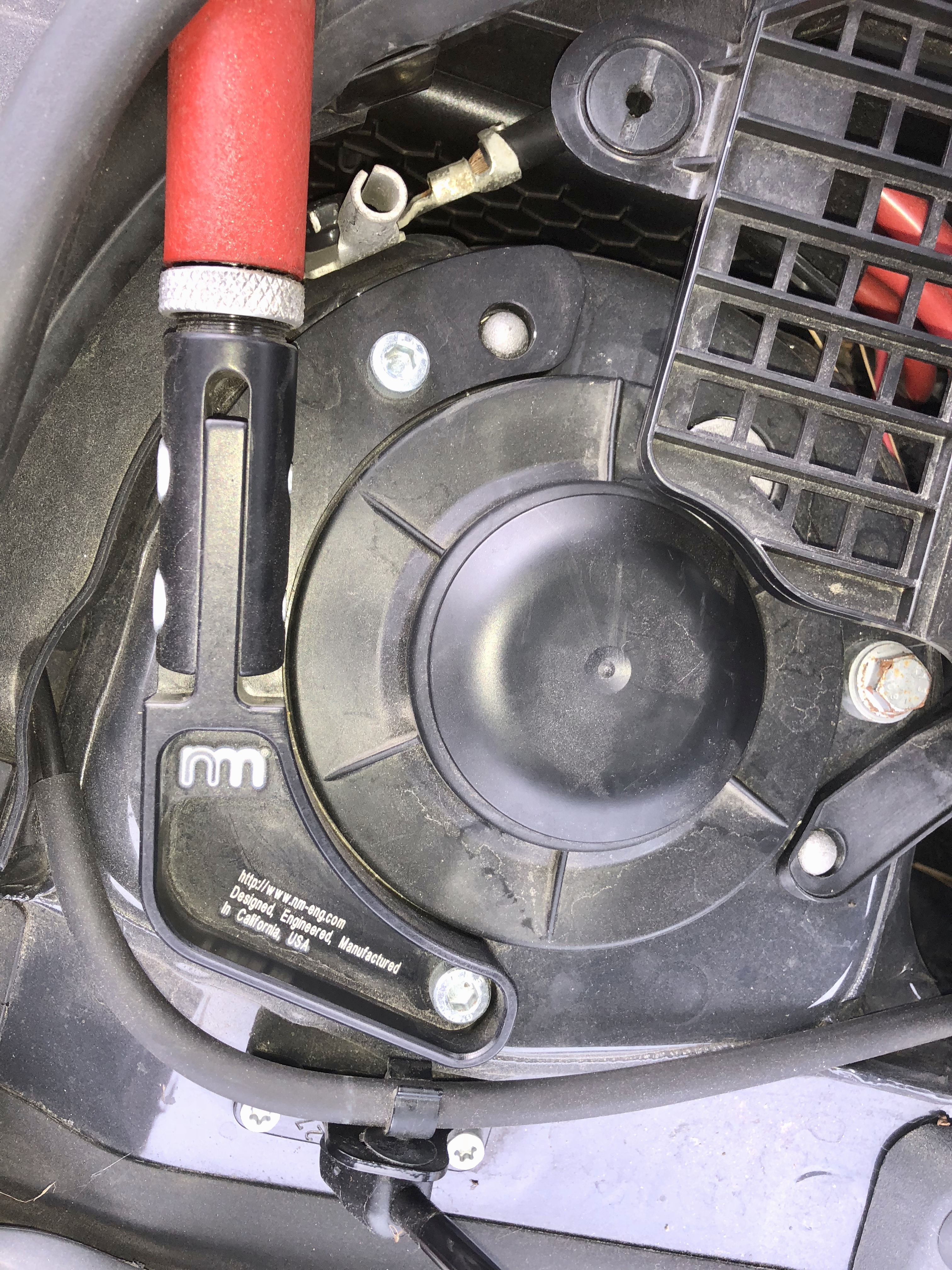

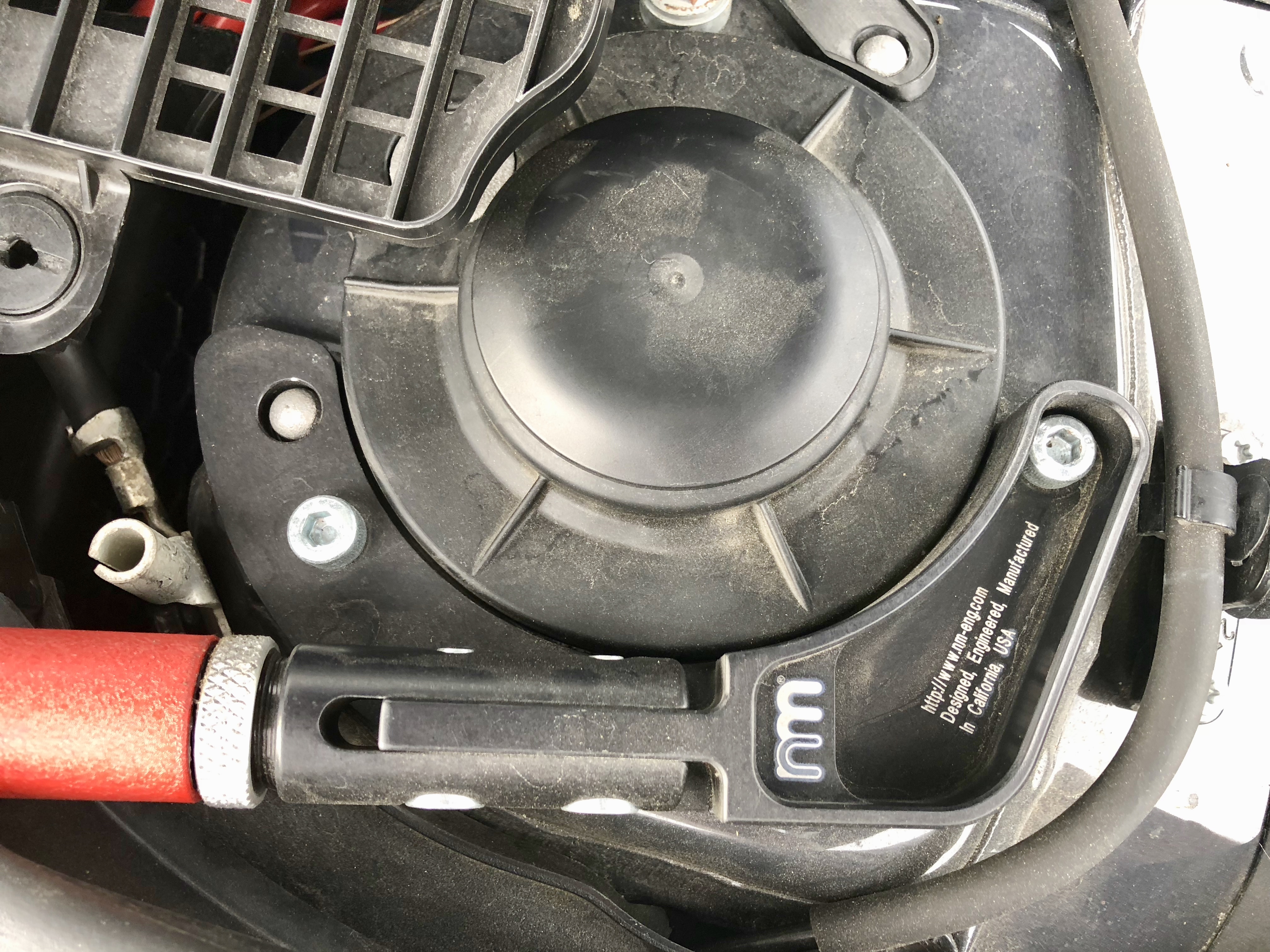

I don't know about the bars for 2nd Gen cars, but the 3rd Gen has different fasteners. My GT bar on my R56 had nuts like you're describing. That was an exact fit too. I suspect the extra slop in those mounting holes is so the manufacturing process doesn't have to be as exacting as would be required for a proper fit. The NM part (at least for my F56) is an exact fit. Hopefully you'll hear back from Jerry at NM soon. If they have one, I would definitely go with their bar.
Attached Thumbnails Installing strut brace, concerned about nuts-fullsizeoutput_49b.jpeg   Installing strut brace, concerned about nuts-fullsizeoutput_499.jpeg

Got in touch with Jerry, made a deal and got the nuts. These fit much better, have a good three or more threads additional to what I had before and go down into the space where there was slop to tighten things up. So far I am very pleased.
I will run these for a while as they are, checking the torque weekly, then when I am satisfied nothing is going anywhere I will put some blue on the threads and be done with it.
Aside from the nuts having to be sourced from NM, I am very pleased. The strut bar is one solid steel piece with no adjustments or attachments other than the stud bolts. I think this should be extremely stiff (the bar certainly is!) and really help the front end. So far, so good!
