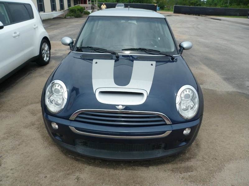

Thank you very much for the education on the paint Capt_bj. The car I was referring to is an '06 that is Space Blue. I think the space blue color is beautiful, the large silver hood stripe....not so much. I am still searching for the right car for me and the space blue MCS is one that I really like. Thanks again!

That looks like a Checkmate, which are super cool.

Yup, that's a factory checkmate!!! Super cool and pretty rare! The triangular a-panels on the sides should have silver checkered vinyl on it, like this.

Thank you for your info Sarom058. The Mini that I was refering to did not have the checkered decals on the side, maybe someone removed them for some reason. In any event, I did not buy that car but did buy an '06 MCS that is a solid Space Blue. I pick it up on 10/24 and I am like a little kid with excitement! Already spent a small fortune on new parts to replace. Thanks again!
