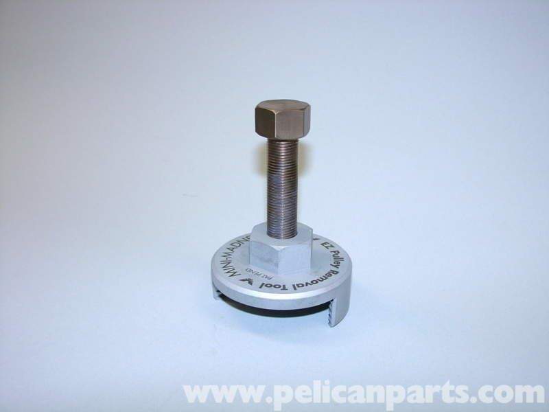

Our tech article says it should take the average DIY'er about 2 hours (this is what it took us on our R53). Those more experienced or those who have done the job a few times can most certainly cut this time down. As said already, having the right tools for the job is what really makes the difference. The Pulley Removal tool really turns a much harder job into a relatively easy one. If you don't want to buy a new one I'm sure you might be able to find one in the marketplace. I see them floating around there from time to time.
