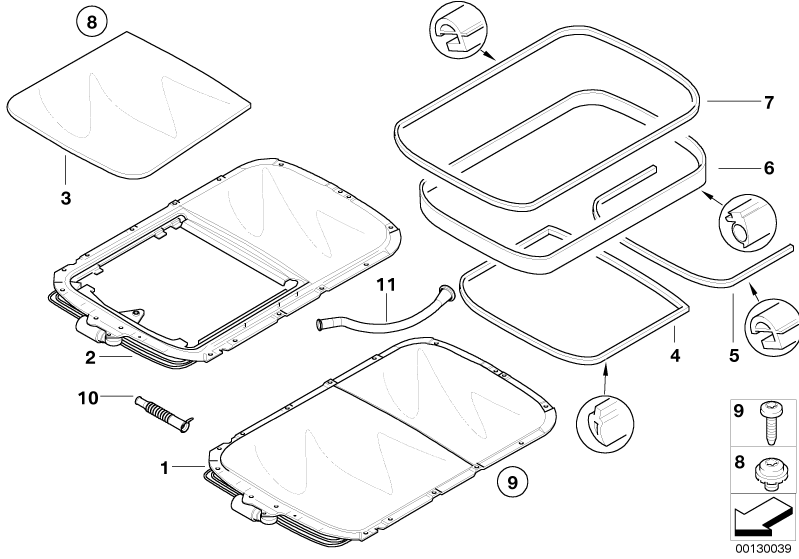

I didn't see your post before I posted mine, so is it working properly now that you popped the arm in?
Here are some diagrams of the sunroof:
888.280.7799 | 6am - 5pm PST
no its still not working, i had to force it shut, it makes a really loud clicking/grinding noise from the motor
