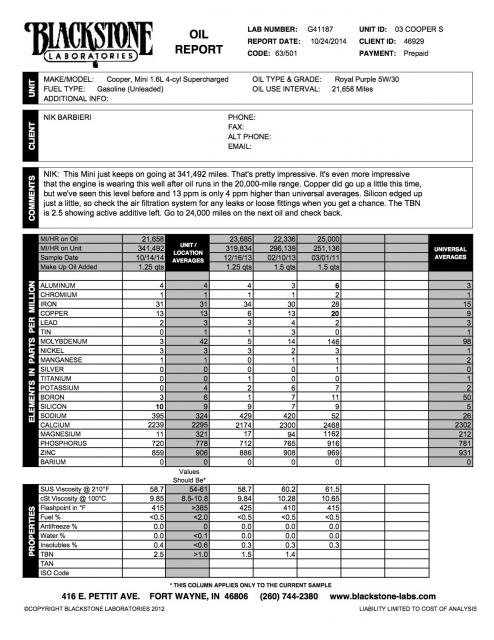

Engine, Mobil1 0-40 euro or MINI oil, every 7500 miles. (Blackstone Lab analysis proven)
Tranny, Redline MTL every 30,000 miles.
