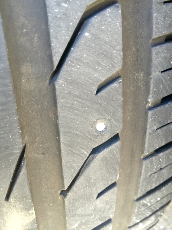

Here's the nail which also shows the current tire tread.

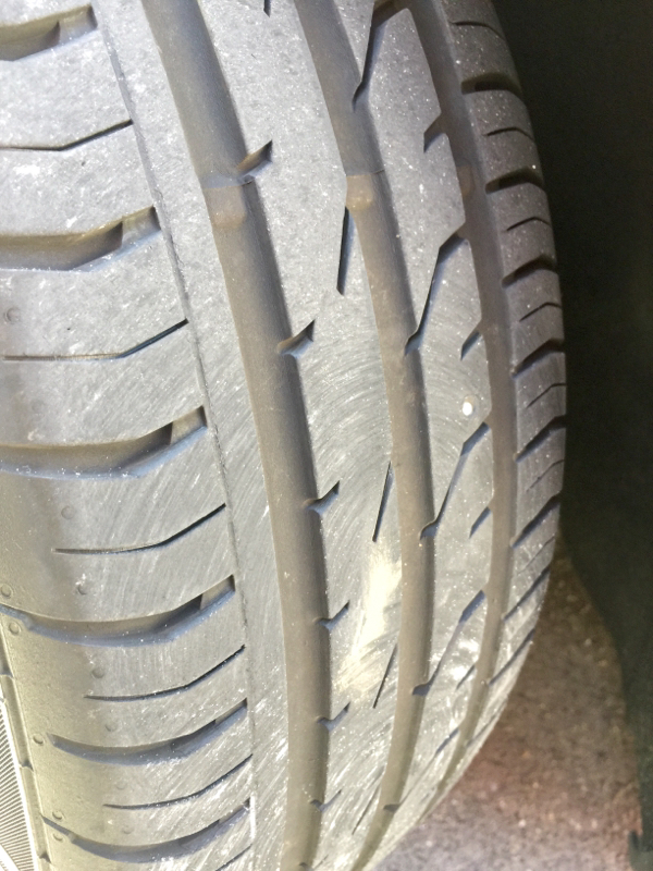

Closer photo

That nail is too close to the side to fix....the photo appears to show it within 2 inches of the edge...most places will fix within 1 1/2 to 2 inches....more than that, the patch fails from the sidewall flex.
If they yank it, and air comes out, tire is junk...
But the nail might be so short, no problem...seen it many times.the longer it stays, the more of a chance it will work its way into the tire body, and into the belts, which will allow corrosion to start, allowing a blowout later, even if it never penetrates the butal layer (air keeping layer)

It's pretty much right in the middle. Of course air will come out when they pull the nail, it's a puncture.
That is easily patched. As long as you didn't drive while the tire was flat, take it to an independent shop and have them patch it for $20.

You have a lot of tread left on that tire. If you have to replace it with a new one, it's not going to be a problem..
