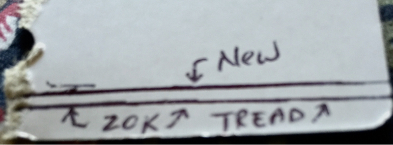

Update: Update: MINI will refund me $700 for the $943 plan because they billed one tire. That said, I mentioned I was concerned about running a new tire (front left) with three older tires with 19,200k on them. It hasn't thrown any sensor/traction lights so I guess I'm good?
Here's a cardboard I used to measure the tread depth on the new vs older tires. The first line (bottom) is the old tire with 19,200k. The second line (top) is the new tire tread. The difference may actually be a tad less than shown.
Will I be OK running Zippy like this?

Checking my monitor with a ruler, and based on new tread of 10/32, the 20K line
measures 7/32. That's close enough for now.
If you rotate the right side twice a year and leave the new one on the left front,
(in other words, don't rotate the left front and rear) they'll all get pretty close*
to the same depth by the time you need 4 new tires.
*no, it won't come out completely even, but it'll be close enough not to matter.
