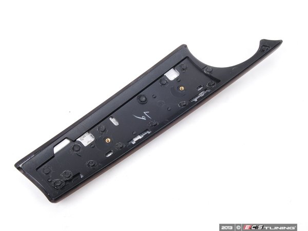

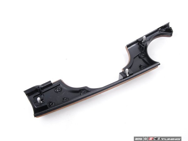

Not too hard, They snap in with these plastic holder and have metal pegs on the back for the one behind the tach. Move the steering wheel down to the lowest setting on the adjustment. pop out , replace the old pegs to the new one and pop it in. On the secret compartment , press and lift up the secret compartment and then two screws on #8
http://www.ecstuning.com/Mini-2011-Cooper-R55-S_Clubman-Coupe-L4_1.6L_N18B16A/Interior/Dashboard/2
Passngers back side.
Driver back side
